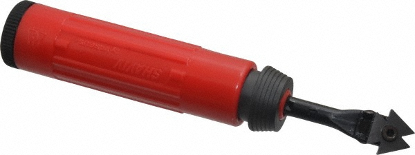

Or hire temp help. How hard would it be to teach someone to remove burrs from 410 edges ?? :Big Laugh
