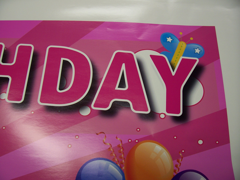

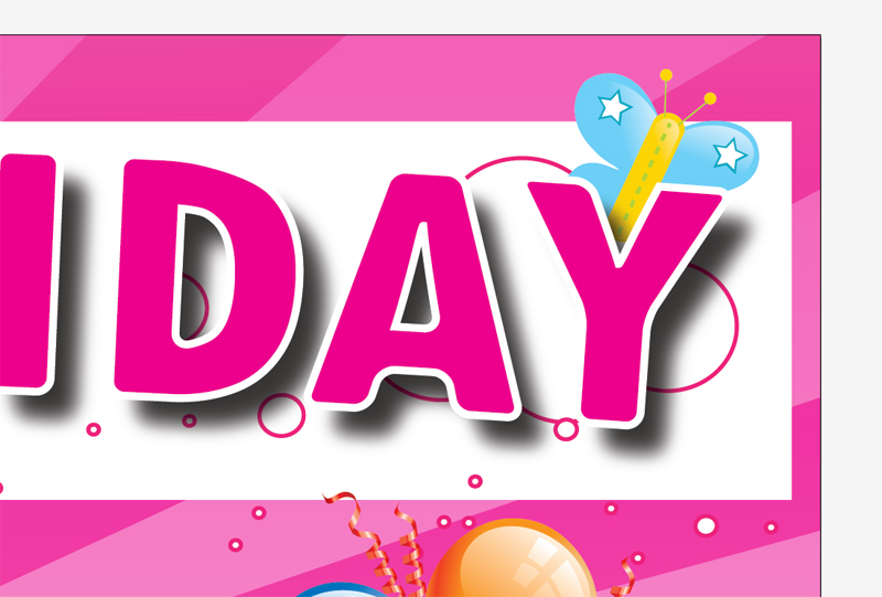

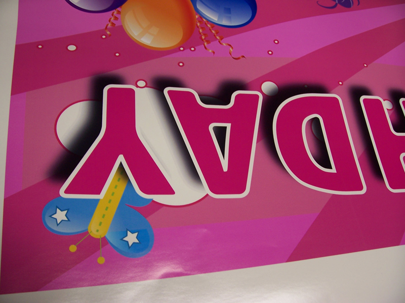

I am having a serious issue with printing a graphic I made for my daughter’s birthday. The only way I can describe this is that once I send the graphic to the Rolland SP-300 printer (From illy, saved as eps, then printed via Versa works) it prints these faded or faint squares behind some of the artwork, that I just don’t see on screen regardless how much I zoom in.
This is very strange because I just do not see why these faint blocks are not on the artwork but are showing up while printing.
I have included both a screen shot of the artwork and a camera image so that you can see what i'm talking about. I'm using illy CS4, Versa works 3.03

Looks like you're Versaworks is doing that when ripping the drop shadow. Try "flattening transparency" before saving the file out.

I tried what you said, but by flattening the trans, it now causes a white block (On-Screen). But that did shed some light on the matter, the white blocks that now appear ARE behind the exact same spots as the ghost blocks mentioned earlier, so it does have something to do with the transparency all together.
