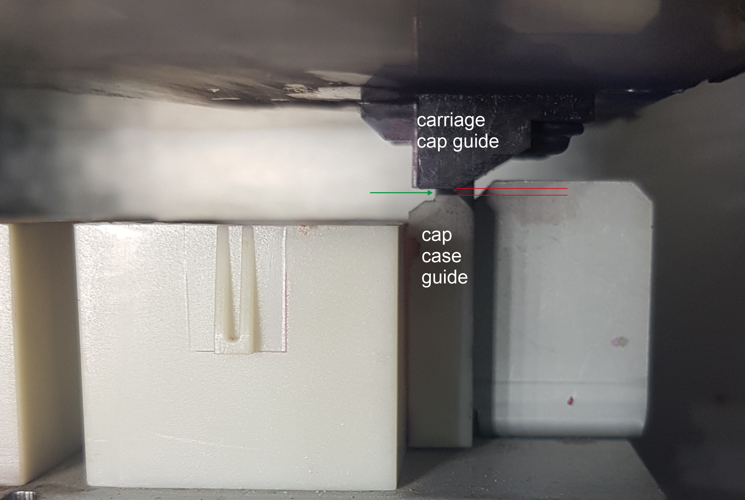

I'm trying to redo most of the parameters (I will do a complete parameters initialization to see if It fix the problem in last resort) and I have always been a little confuse about the "flushing position" : is right that the good flushing position is when the carriage cap guide and cap case guide are in slight contact on the green arrow aera fo this picture ?
