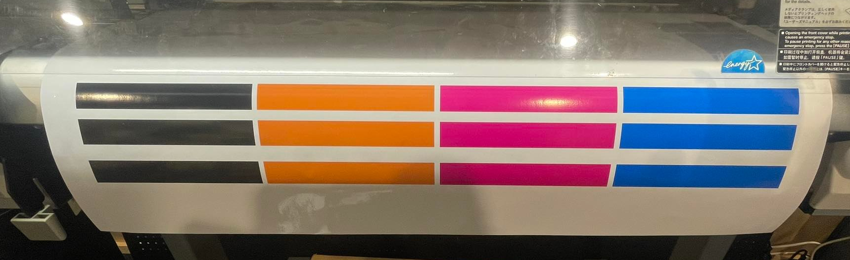

Hi,
I recently went overseas for 3 weeks and was told to head soak the printer heads and power if off as it wasn't being used and that would be ok.
I have got home and run a test print everything seems fine but the yellow is printing orange, I'm assuming this is cause of the cap tops were soaked it dragged some of the other colors across to the yellow?
local Roland dude has said to set up a 100% CMYK print and keep printing till it clears but I have done a few now and still no luck.
Does anyone have any ideas or should I just keep printing till it's cleared?
Attached a photo.

Probably cross contamination. It's takes persistence to clear it. Head cleans. I don't remember the Roland procedures but if there is an ink fill try that on the yellow channel. Printing blocks will take forever.
ToTo
Professional Support
You can easily check in the tubes and the damper how much ink has been contaminated. I would suggest to pull the ink directly from damper using a seringe. This is way faster. Just remove the alloy plate and pull gently the damper from the manifold.

Check your ink cartridges. One may be empty or close to it. If it is it will siphon ink backwards and mix with what's left in the line and cause what you're seeing. At least it did with my 540V.

As mentioned earlier I would probably change the dampers, as they could be going and that is what is allowing magenta to go into the yellow damper, but if you don't currently have them, then using a syringe on the line after the cap top and pulling the ink through should help get you buy until you can get some in.
