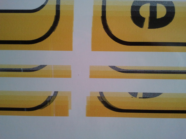

hi guys, this just came up and i have no way to explain but with a picture...
its been printing great, all inks are more than half full
any ideas on what this problem is?

Did you run a linear calibration after re-inserting the freshly cleaned encoder strip? It will help you verify that it is 100% cleaned or not.
