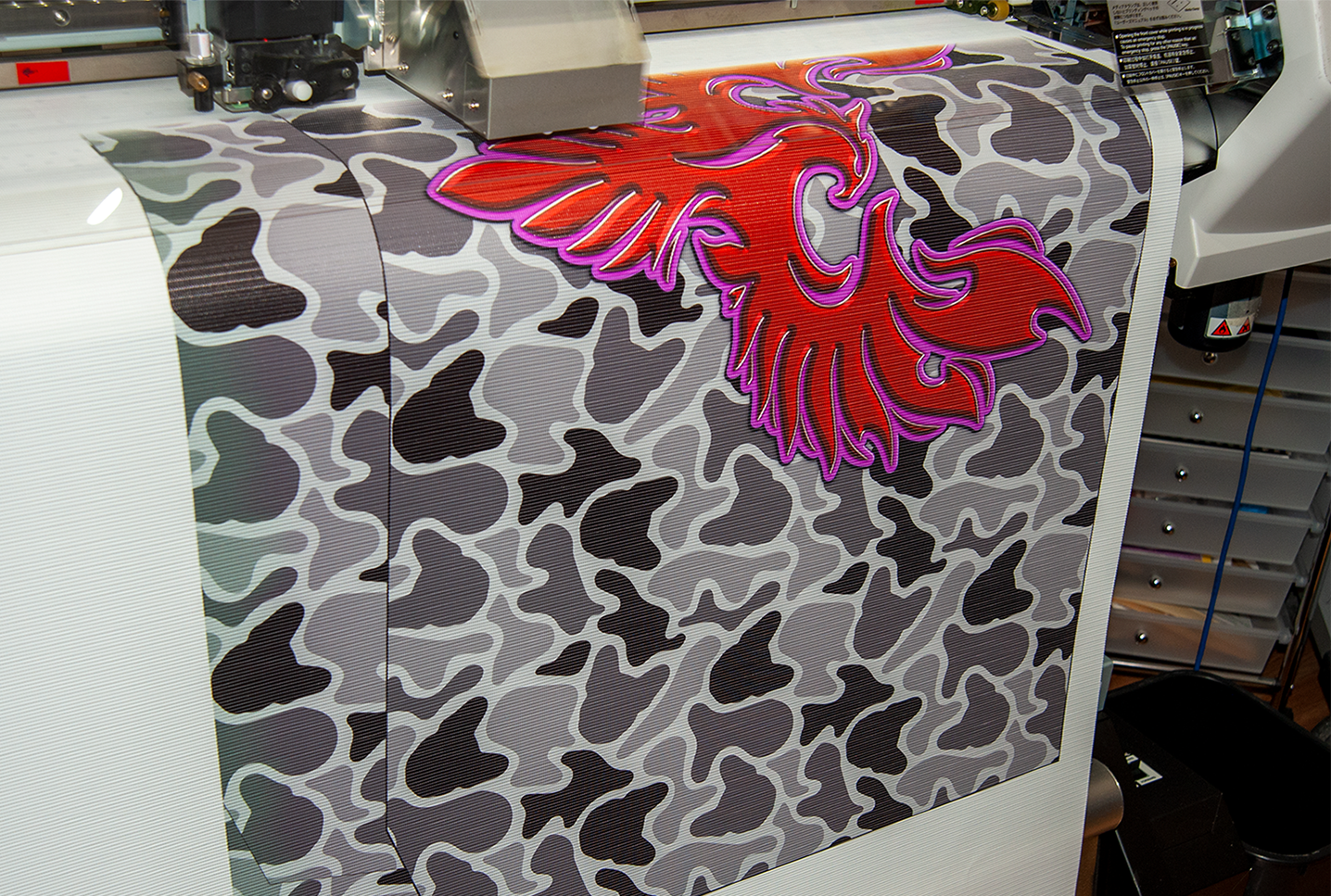

Hi Jim, I think I have a ink starvation issue with my magenta print head, the nozzle test print looks perfect, however, when printing a larger image with my SP540V, it is printing correctly until the far left side of the image and then the magenta would drop out (you can see it in the gray camo image attached). On the far left when the magenta inks runs out, the gray camo looks greenish. I changed the damper and that did not fix the issue.
To complete the job, my work around was to add about 6 inches of extra image that would be trimmed off later, and then the greenish cast would be printed on the area to be cut off.
I have not been able to fix the issue and after reading your suggestion in this post (you bring up some great info). You mentioned something about the needle that punctures the ink cartridge getting clogged, could that cause the magenta print head to be starved when printing, or do you think the magenta ink lines needs to be flushed out?
Or could I have an air leak, and if so I how do you test for an air leak in the magenta ink line? Thanks

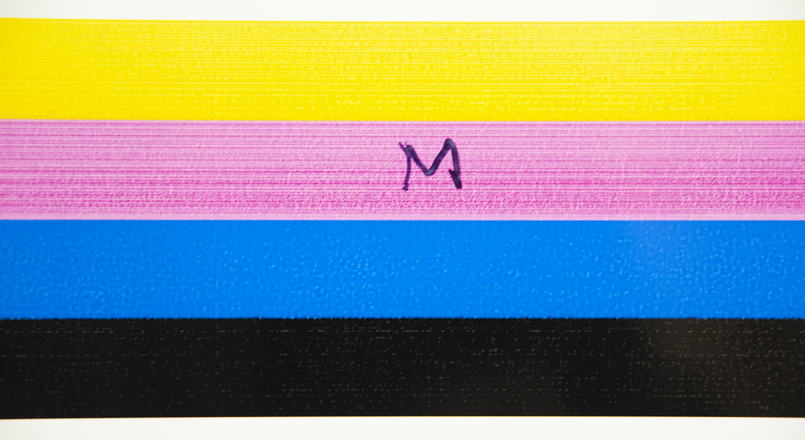

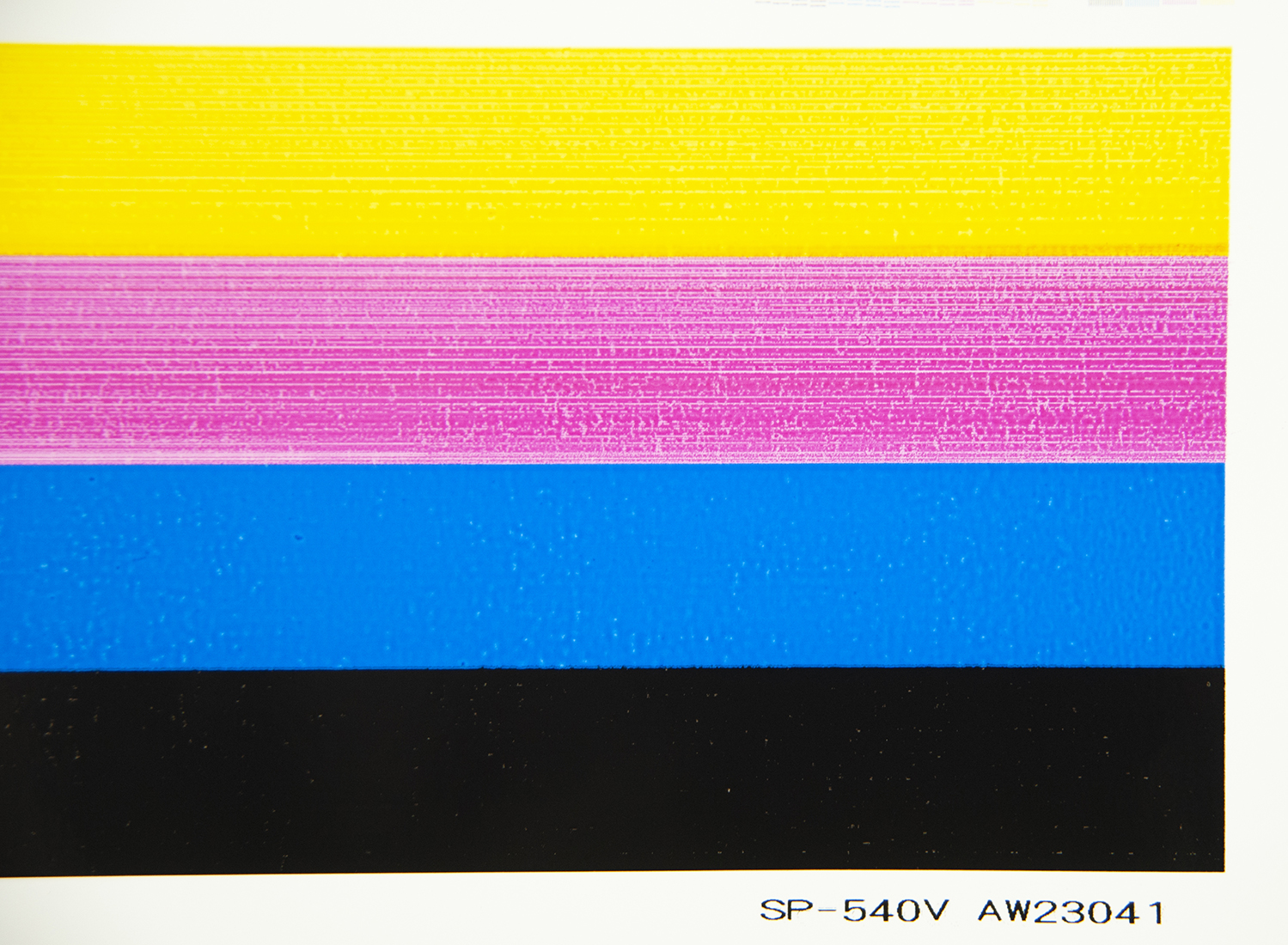

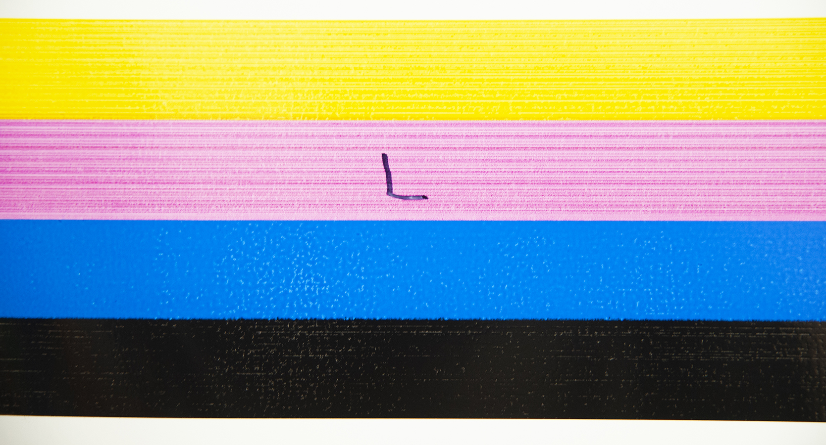

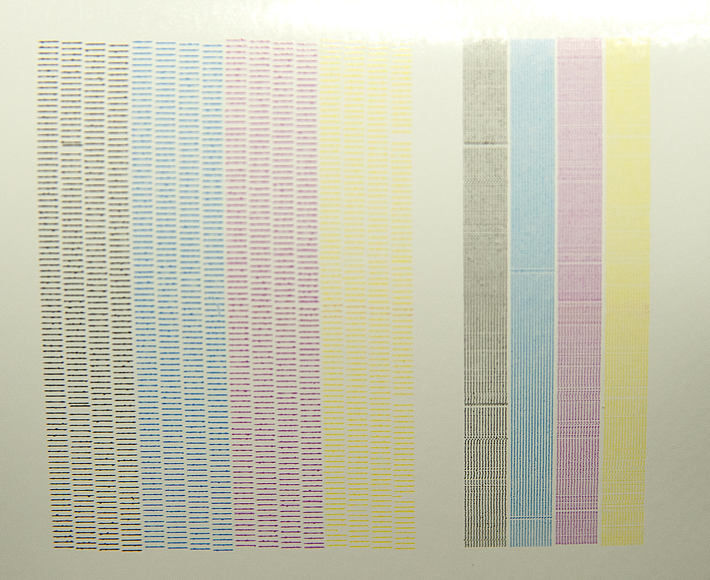

Jim, here you go. It took me a while to get into the Service Mode, 3 photos of the test pattern fill (right, middle, and left side), and the test print made right after.
The blotchy print is because I am using an very old 54" wide roll of 3165 vinyl, however the magenta is showing some streaking, which increases going towards the left side.
Also, I see a slight hint of magenta in the yellow?
What would cause the streaks in the magenta? Thanks

Your magenta/yellow head is failing. Time to replace it. No point in head soaking, as the magenta streaks in the yellow indicate the magenta channel is having firing issues, so the problem is electronic in the head, in my experience. Replace the dampers at the same time. You can go into service mode and get an idea how much usage it has by printing the history report in service mode and looking at the shot count. It will be H2, 3 being magenta and 4 being yellow. When you do replace it, be sure to enter the head rank and clear the shot counts for that head.

Jim, you were 100% correct, I replaced the M/Y head and my SP540V is printing great again. I also pulled (flushed) cleaning fluid through all 4 ink lines and installed 4 new dampers. Thank you!
