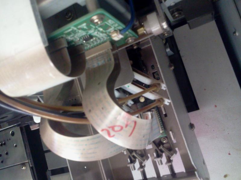

A buddy is having troubles with his Roland, the lines look cross-contaminated to me, as both look the same color of yellow-orange. The test prints are showing major issues also.
The customer just recently had two different techs out to do service on the machine a month ago. One put in new capping stations, new wipers and maintenance kit. He also had the heads ultrasonic cleaned, and after that the printer was working great for a week, then he didn't use it for a week or so and came back to this mess.
I can take pictures with my cell if that would help with diagnosis, but that's the best I can do up here.
Where does everyone suggest starting at on this problem?
I haven't had to work on this machine for a couple years now so I am a bit rusty!
My cell is 513-200-3004 if anyone has experience with this printer!

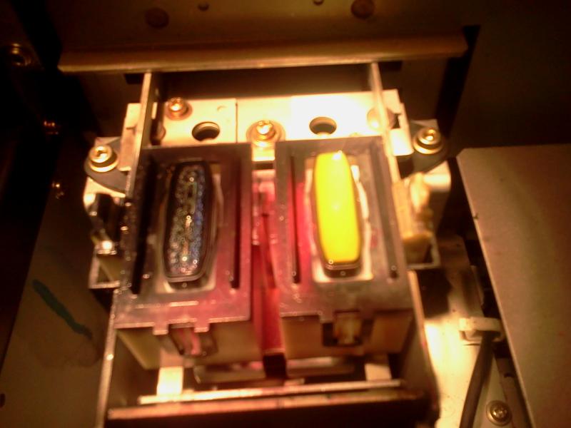

The Yellow/Magenta Capping Station(?Is this what it's called?) doesn't appear to be draining like the Cyan/Black one does. How do I check that out?
I know my photos suck, they're the best this Verizon phone can do.

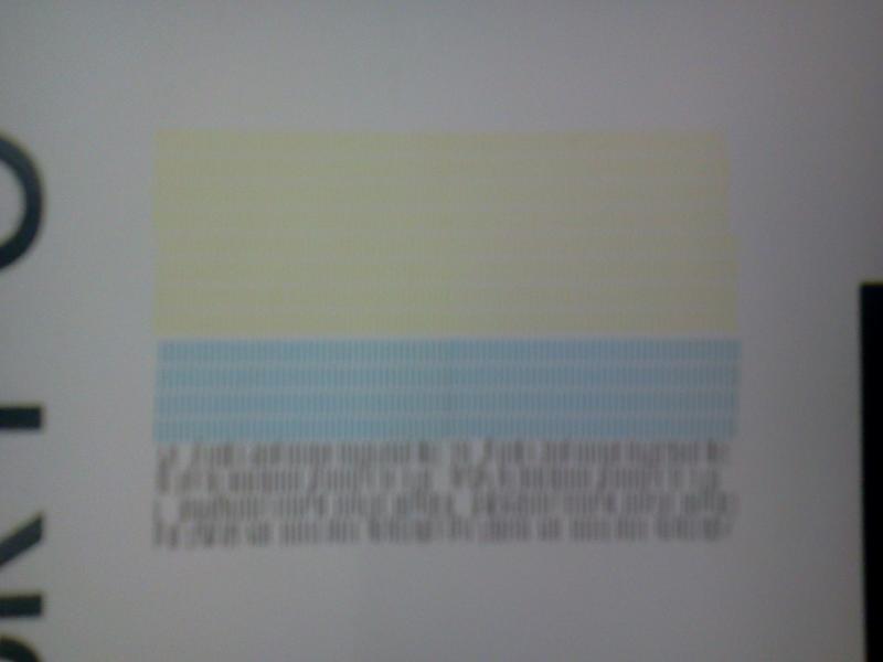

Here is a test print (again, I apologize about the fuzziness!)
The black looks a little funny and "oversprays" around some of the lines, but I have seen worse....
The Yellow and Cyan both are the exact same color on the sheet, but it looks like all nozzles are firing correctly. Where do I start checking or pulling ink/air through?

It looks to me you may need to clean out the ink lines going to the waste jar. disconnect the line from the capping station and try to push some cleaning fluid through the lines with a syringe... and let the machine do a cpl. of head cleaning.

I unplugged the lines and siphoned some through manually with a syringe. The yellow/magenta appeared to be clogged at first but is flowing good towards the waste now. I just did a medium cleaning & am now printing a large swatch of only magenta. The magenta line leading to the head is now "orange" compared to "only yellow" earlier.Some progress is being made!

It was the capping stations, sorry I didn't get around a computer again until now... after the drain line was cleaned out going down to the pump I did the "ink pump up" once, then a medium cleaning and the mgenta ink tube started to look pink again. After that, I just printed some large magenta rectangles and watched them change from yellow to orange to pink!
He's back to printing great again, thanks to everyone here and the search function here telling me to try the capping station. I guess with incorrect suction one line can start flowing up into the other and causing contamination.
