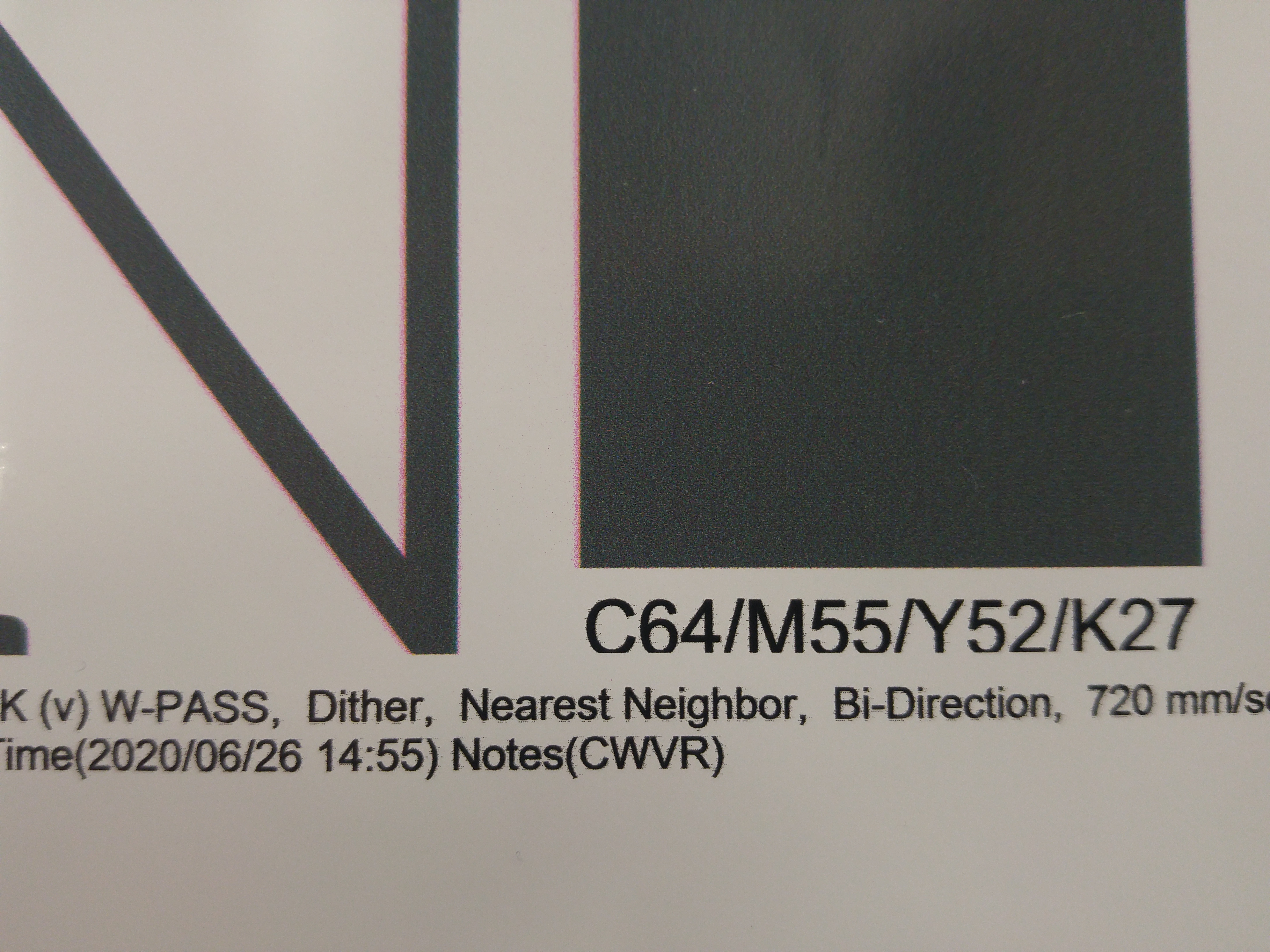

Getting a fuzzy magenta blur on the edges of vector objects.
Roland SP540V, Versaworks 5.5.1, EcoSol Max Inks.
Printing on 3M 40C Matte. CWVR-HighQuality-Sign&Display. Head Height Low.
Issue improved slightly after changing the media profile/type to "Generic Vinyl 1", but is still there and is still noticeable.

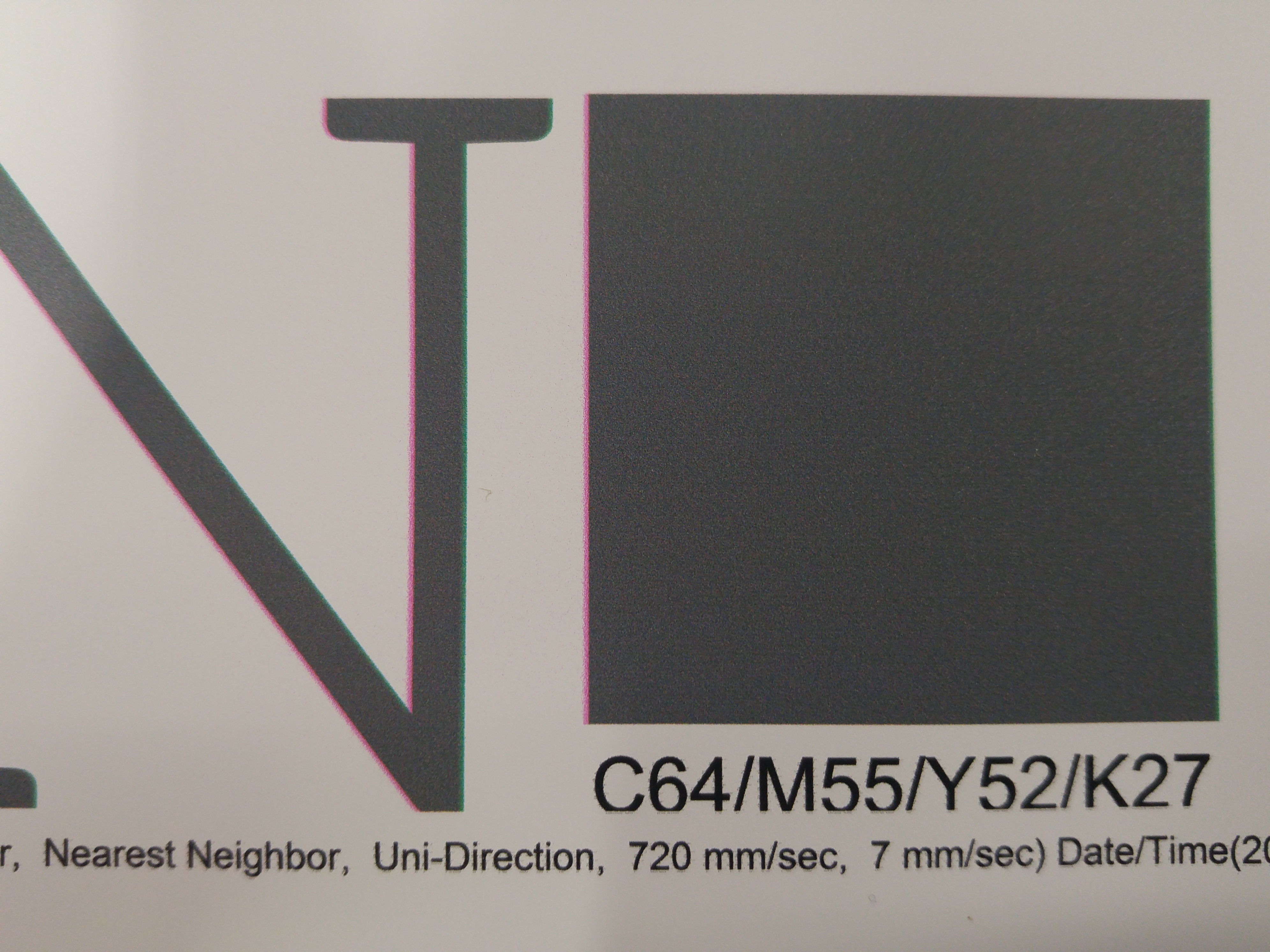

Uni-directional printing didn't change results. Testing on various media (3M IJ180cv3, 13oz gloss scrim, 13oz supersmooth blockout) didn't change results.

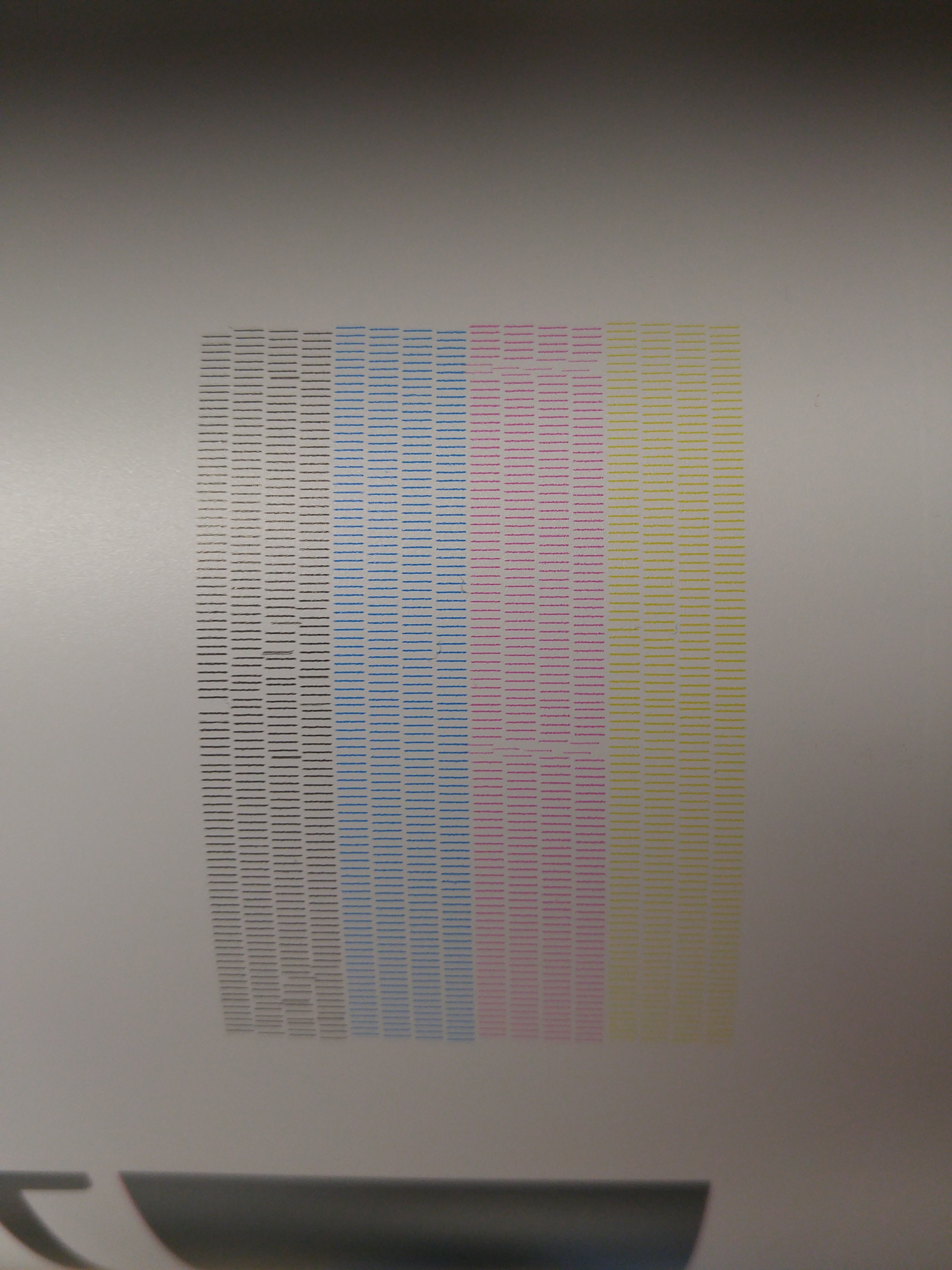

Nozzle test is okay, not great, but I've seen worse.

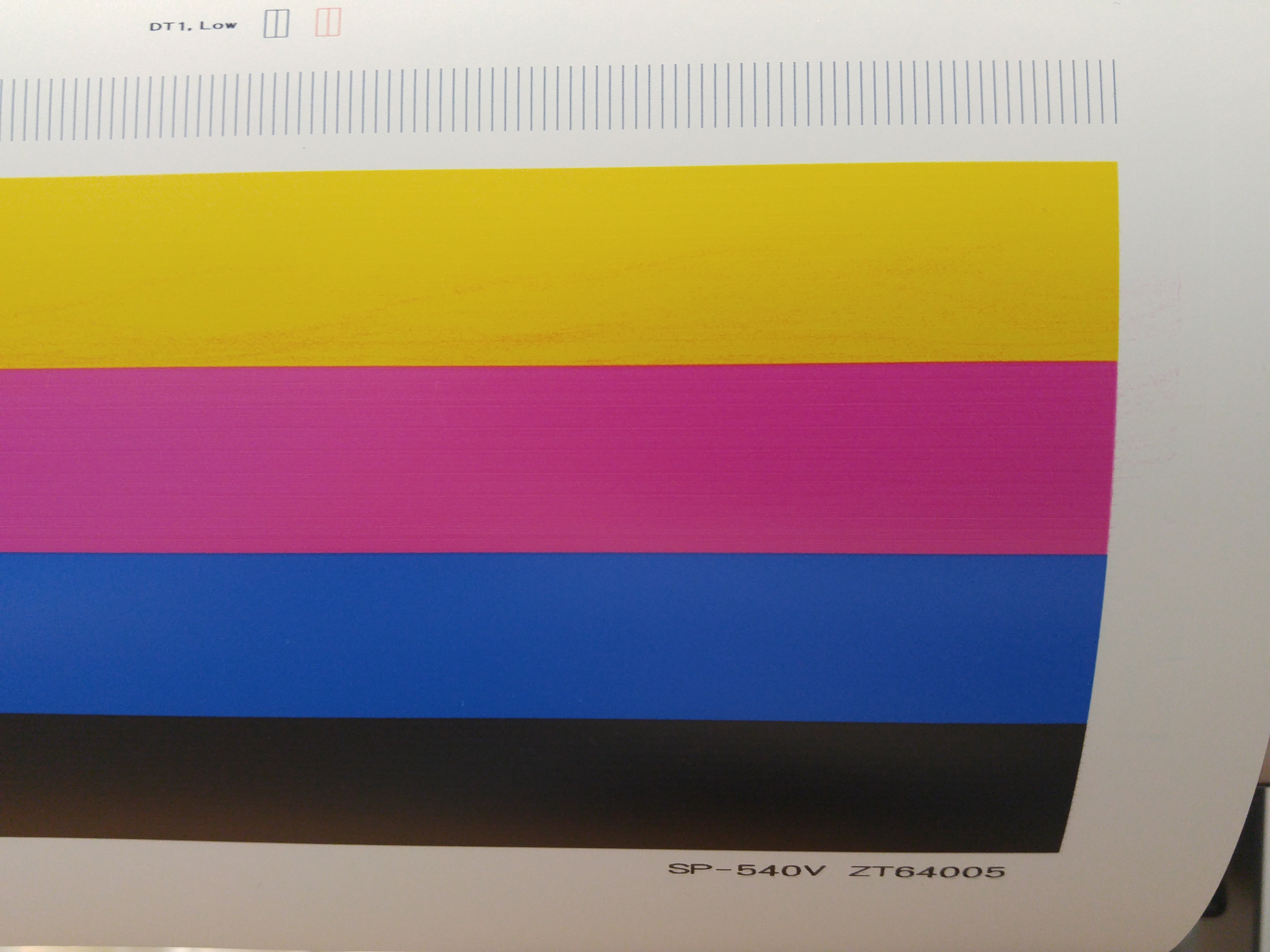

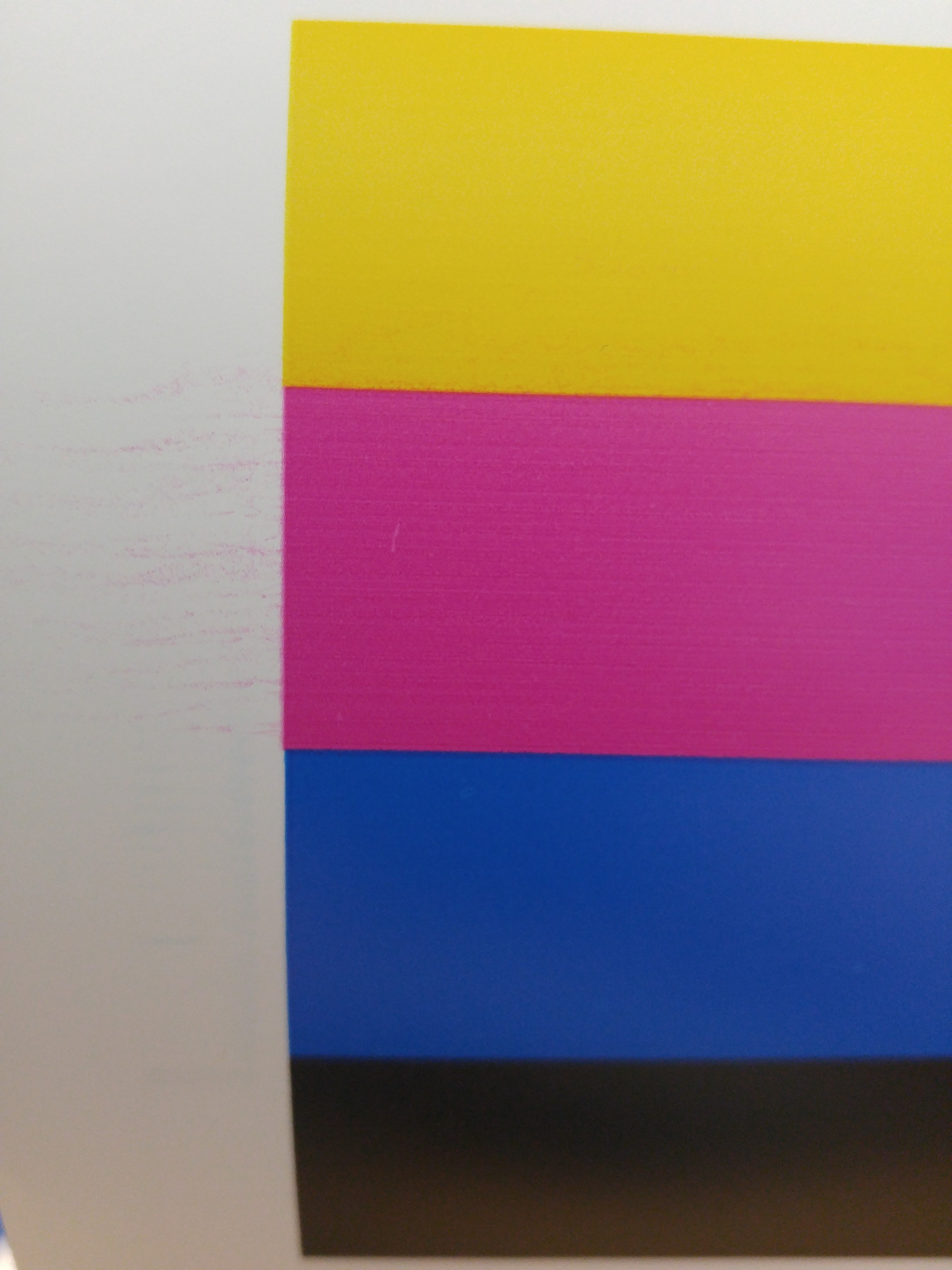

Fill test is icky. Fuzzy magenta edges. Magenta streaks in the yellow. Magenta is stepped out from the cyan.

The second picture looks like it was from before the bi-directional alignment. The others look like over spray which is usually a sign that the head is failing. You should soak the head to see if that helps with the deflecting nozzle sin your test print. Sometimes that can do the trick quite nicely. Last resort would be flushing the head manually. Sometimes it can also be a static issue. Check your humidity and temp in the room to make sure you are in spec. Other than that, clean everything really well but be prepared to need a new head.
Thank you Solventinkjet. I will try the head soak today.
I've noticed some slight over spray lately, and have accepted that it's probably time for a new head.
