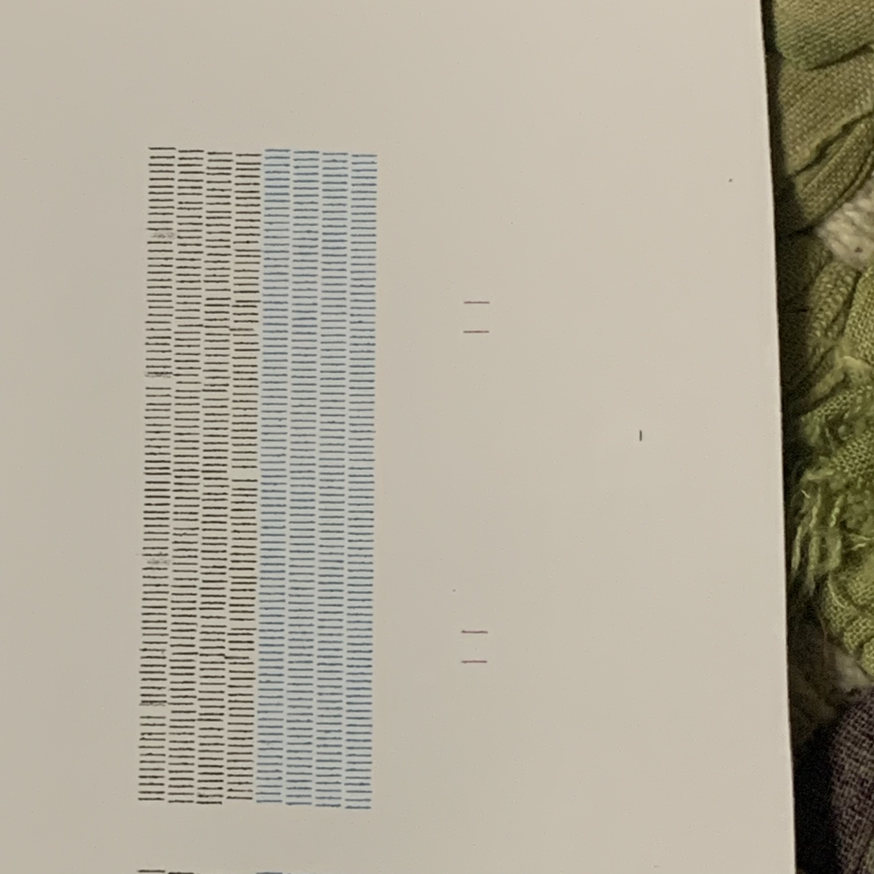

Ok i just put in my new head, filled ink per service menu and printed this test.
Any idea what is wrong? I out in new head rank properly.
I can really use some tech advise asap thanks!
Solventinkjet
DIY Printer Fixing Guide
Looks like either you need a new cap top and/or the line is clogged/partially clogged from the cap top through the pump. Some nozzles are firing so you didn't pop a fuse. Ink just isn't flowing enough to fill the head completely. On an SP300 you should be able to fill the system with 1 maybe 2 strong cleanings. If the filling in the service menu didn't completely fill it, I would flush the cap top tube, the Y connector it connects to, and the pump/waste tube to make sure none of them are clogged. If they aren't, I'd start with a cap top.

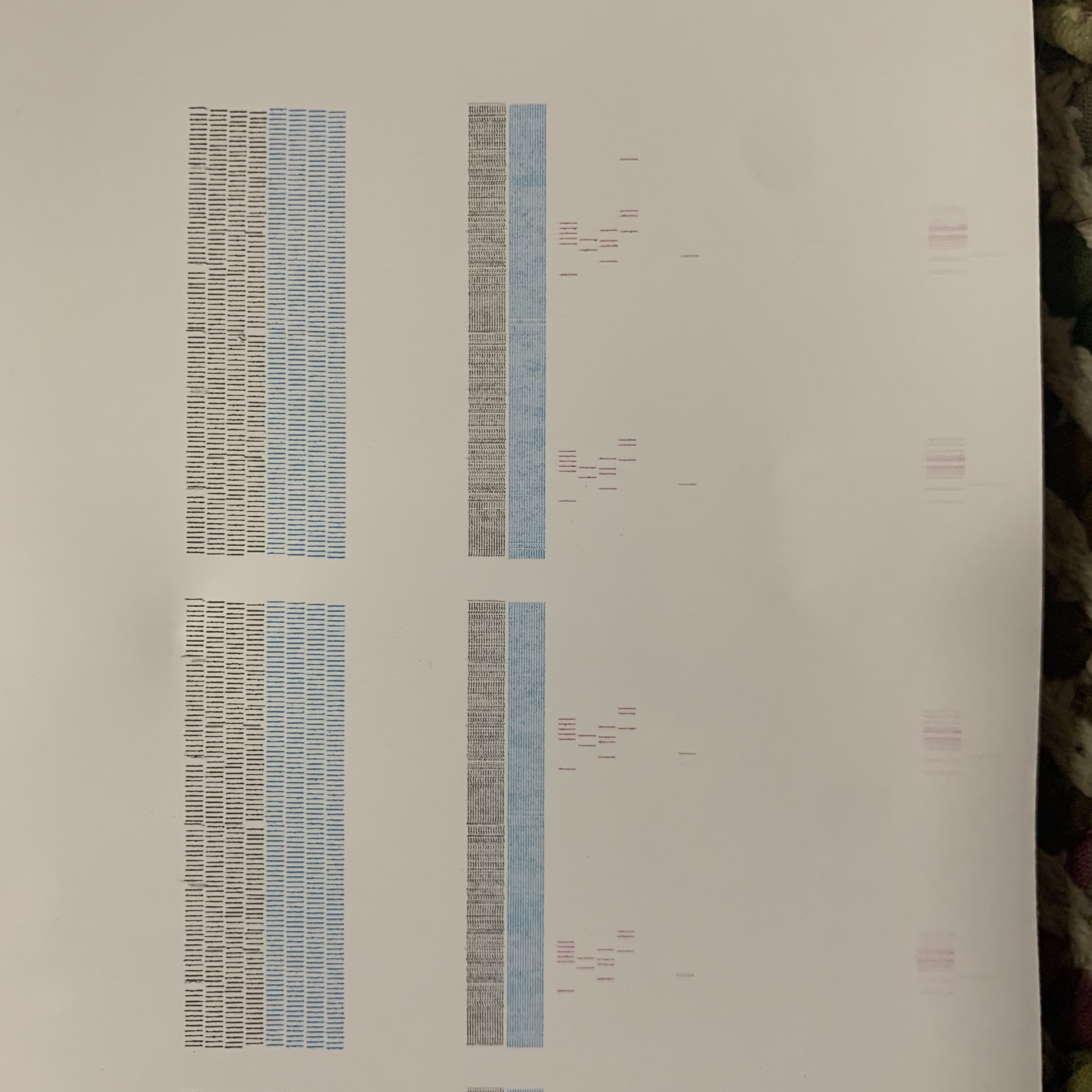

I just switched ribbon cables k/c to m/y and put m/y on k/c. Printed this now. I did put new dampers in m/y and visually see them all filled up with new ink. Printing test via service mode and why do i get the small nozzle test too? Should I not print test while in service mode?
Solventinkjet
The dampers can have ink in them and the head might still not be 100% filled. Since you are getting some nozzles to print, you don't have an electrical issue. How did you initially fill the system after the head was installed? Did you suck ink into the damper with a syringe or did you run an ink fill / cleanings?

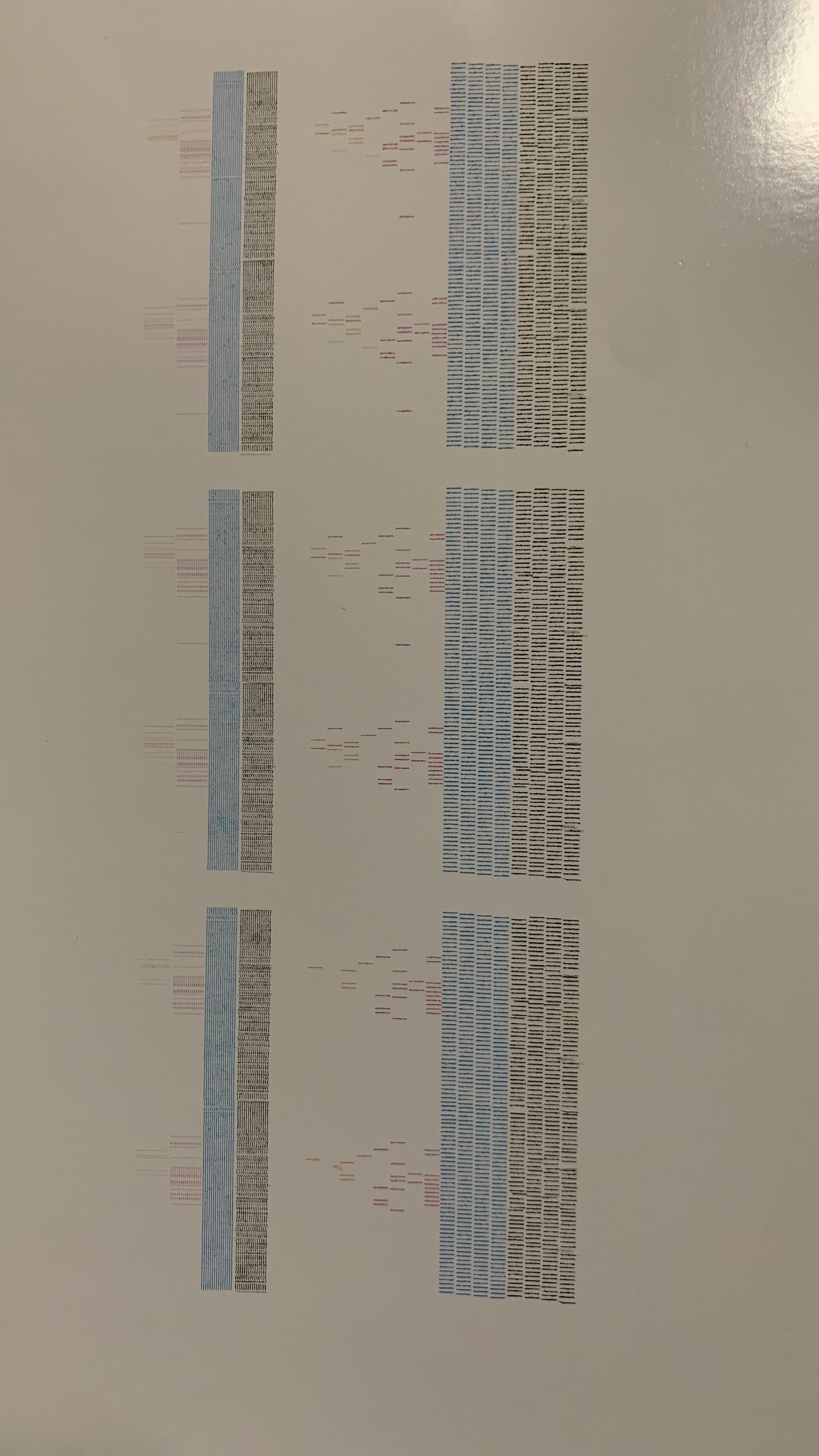

I did ink fill while in service mode then just now one normal clean. I see LOTS of M ink in cap top bubbling down down drain tube so i guess it has ink in head?
geckophoto
Just did power clean and still no y printing minimal m ☹️

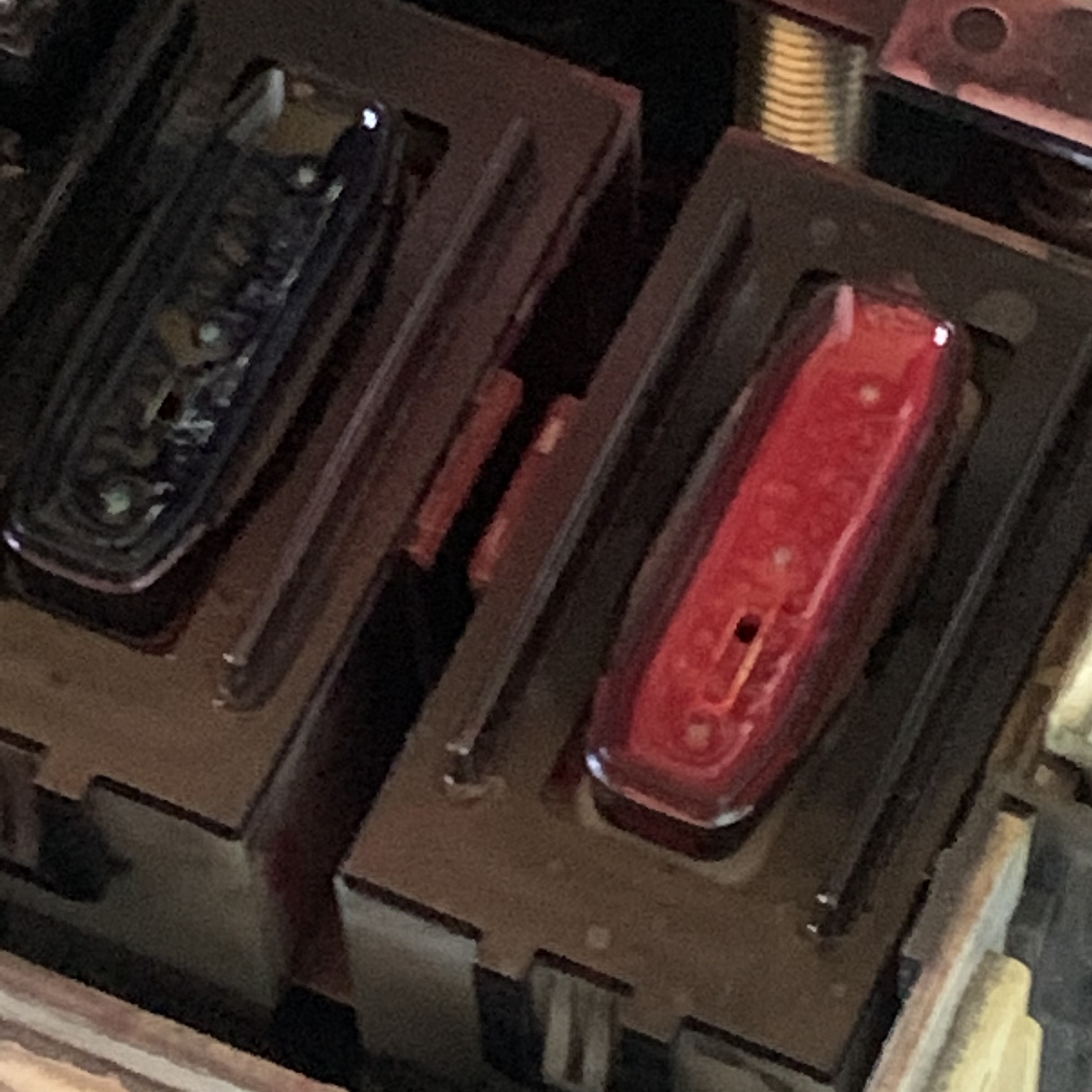

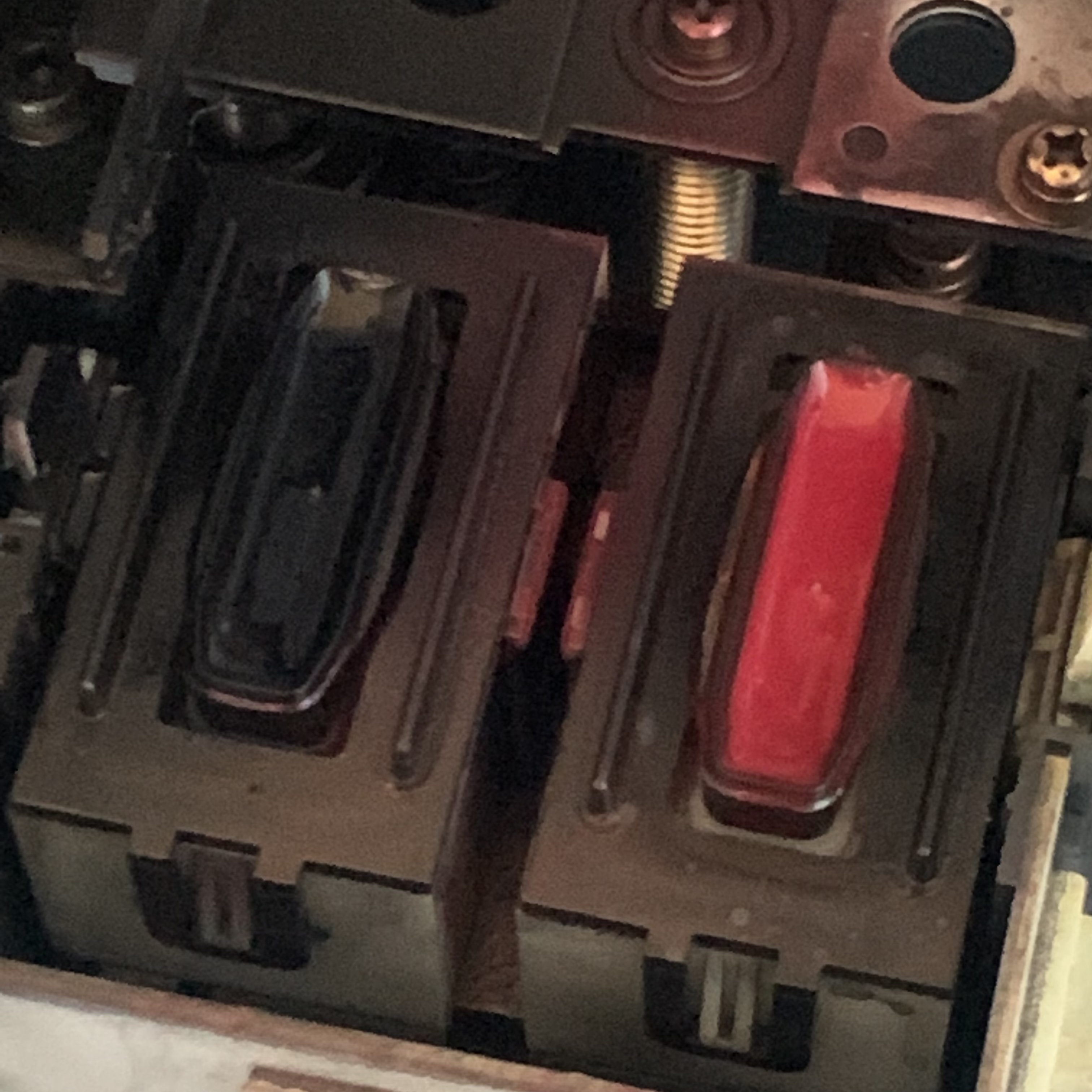

Pic of cap top as heads move left over wipers so i see lots of M ink pumping out?
netsol
did you saturate the felts on the captops with flush?
put a syringe on the hose coming out of the captop?
new damper?
make sure the llines to the pump are not clogged

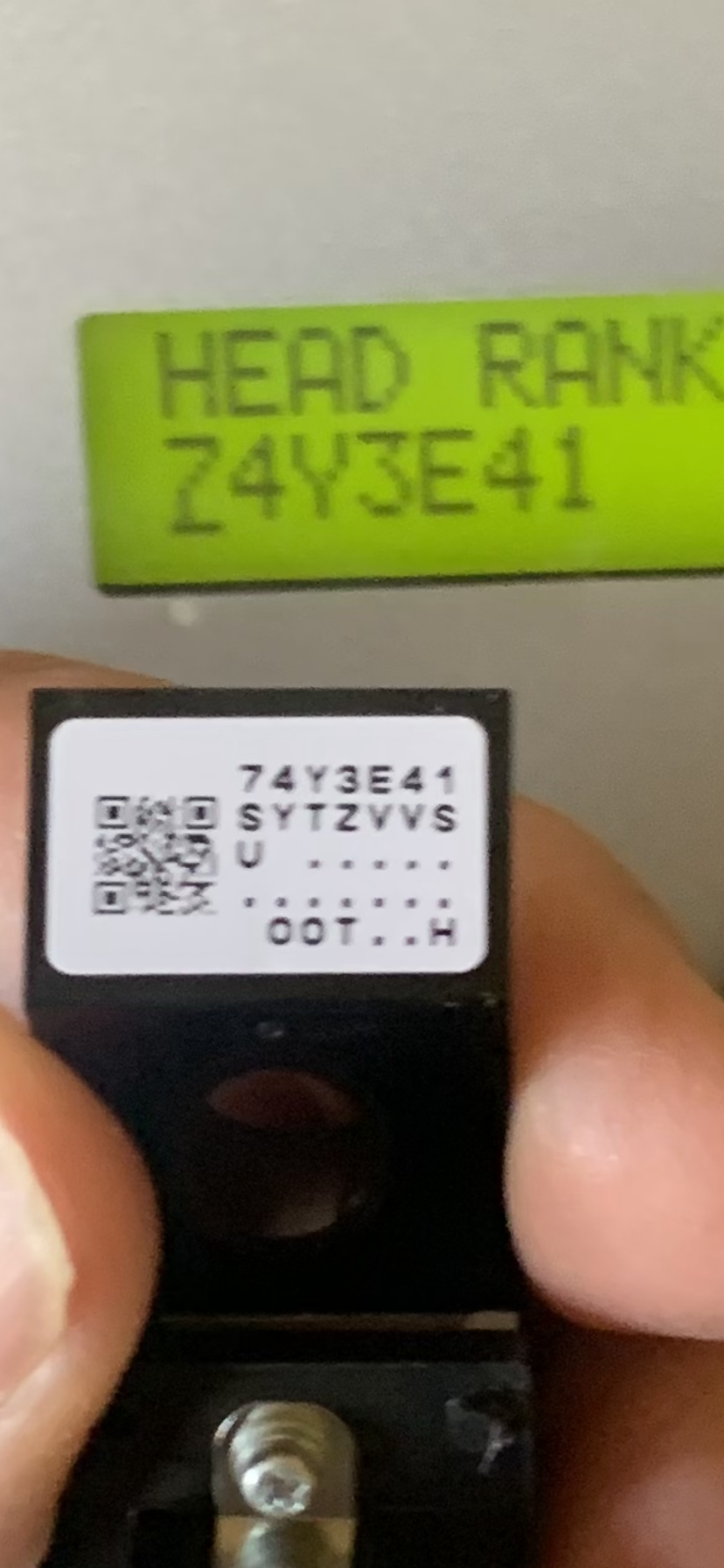

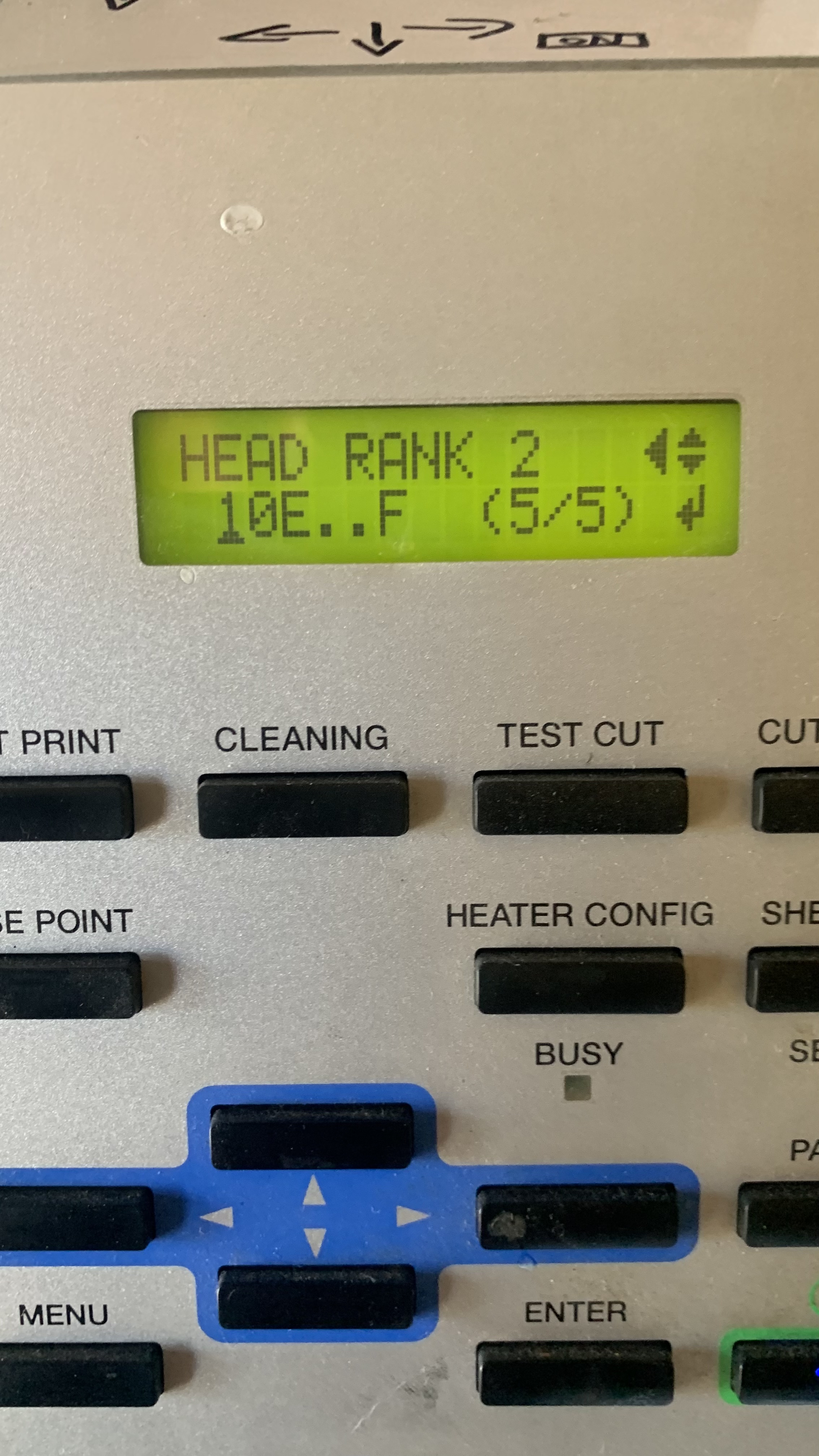

When changing head rank I put these in as zero’s/numerical. Is this an issue? I trued to get keypad to show me alpha/O’s but it would only show numeric zeros so i assume this is correct?
The pic i took in 5/5 is old head rank number with new rank number on head im holding.
