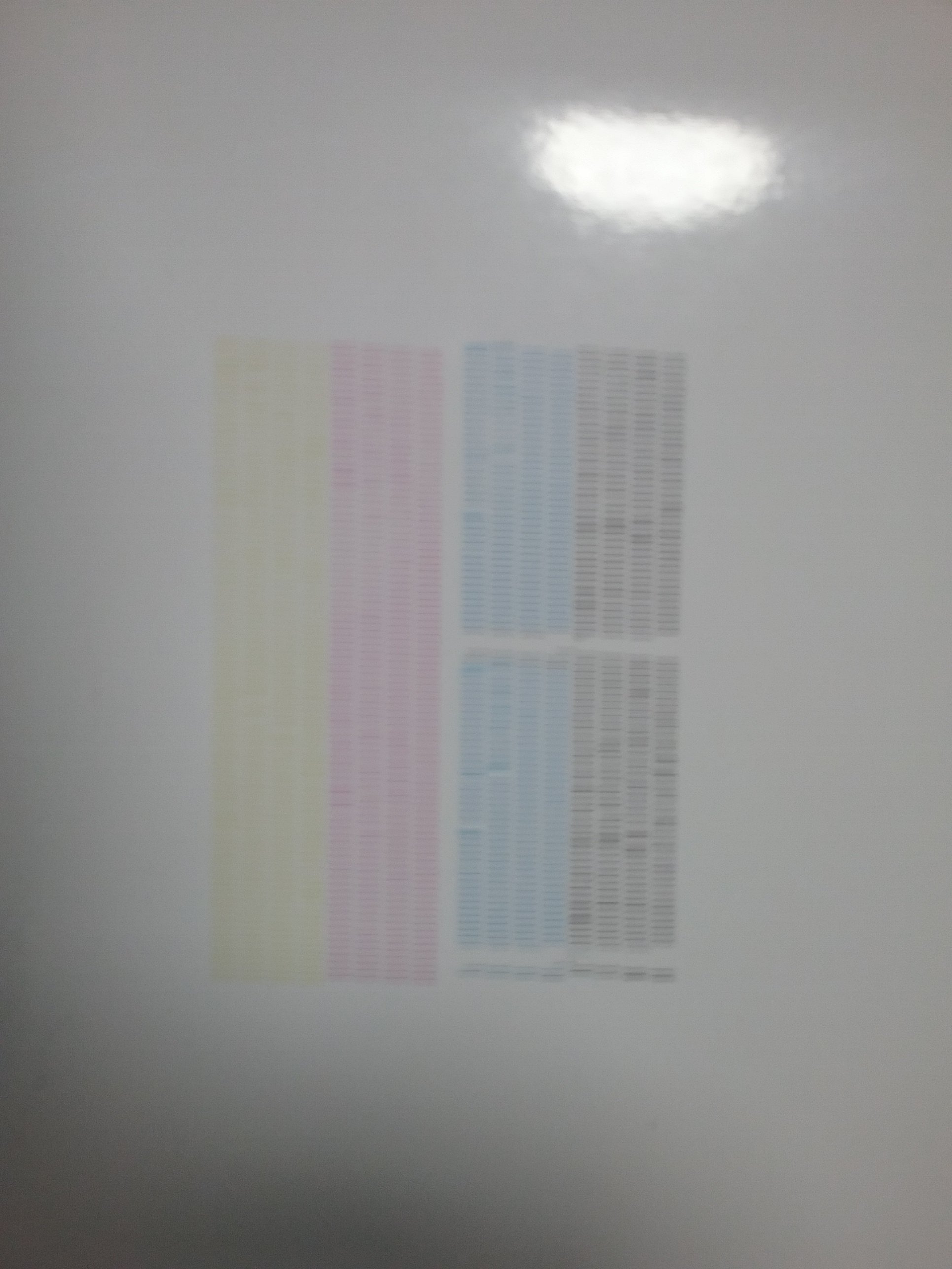

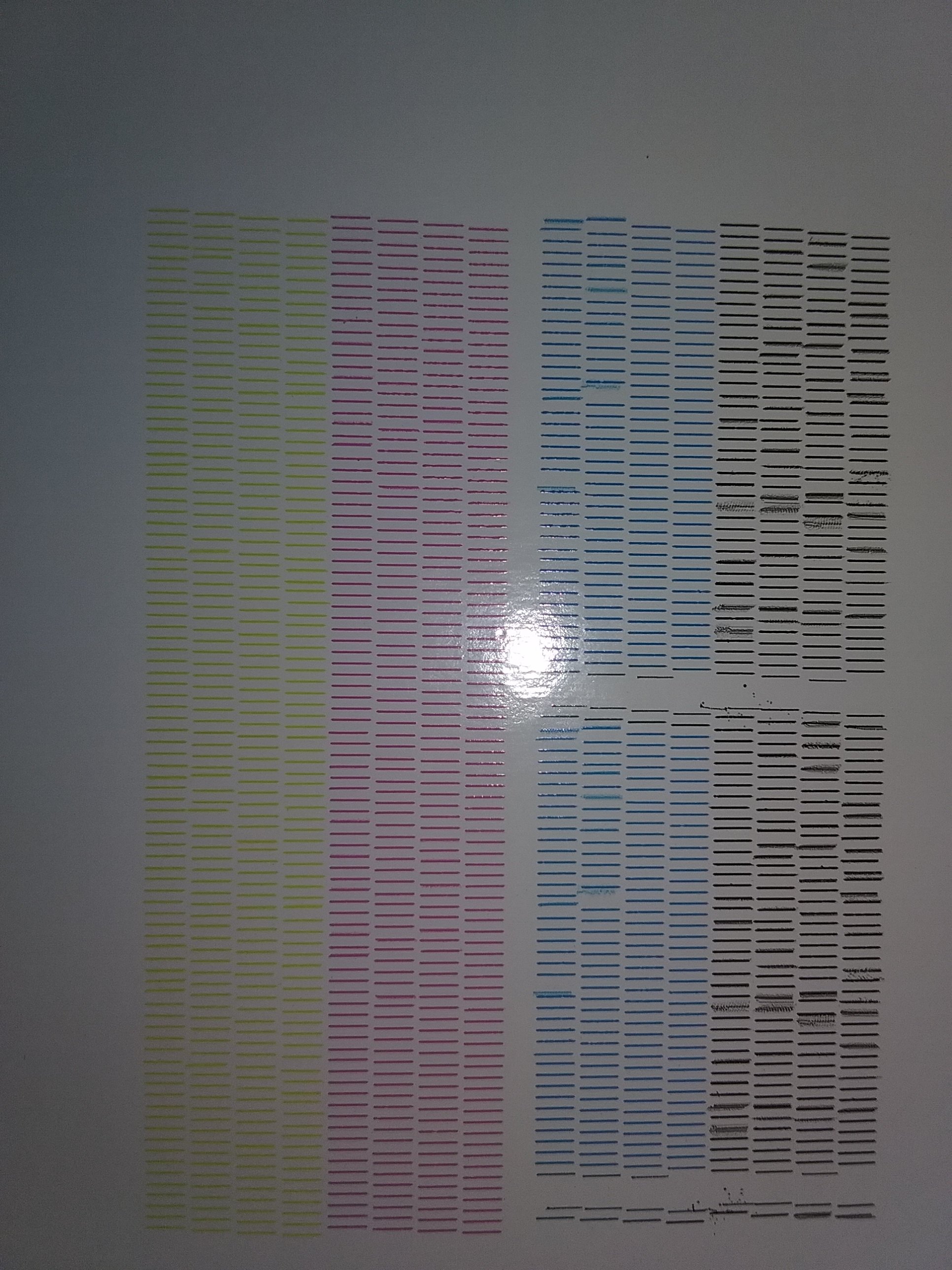

OK so i put a new Linear Encoder board and strip also cut carriage cable in and now i get a space between the magenta and blue on my test print still doing some cleaning as it was down for about a month any help would be greatly appreciated Thanks
