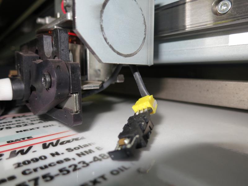

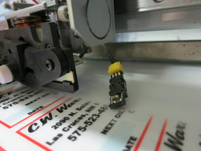

SP300V DOWN! What in the heck is this? How can I fix it?
Have no clue what happen. All of the sudden the printer started beeping.
This little thing got hung up on the pinch roller.
What is it?
How do I fix it?
Looks to be attached to the bottom of the cutter?
Thanks!
:rock-n-roll::rock-n-roll:

It senses the end pinch rollers to tell the machine how wide the media you have loaded is. You need to re-attach it if its not broken or replace it if it is broken. If its not in the correct spot or not working you wont be able to set up any media.
How close does it need to be? I cant find any pictures of it on the cutter.
Hard to tell but it clips in on the back on the cutter head

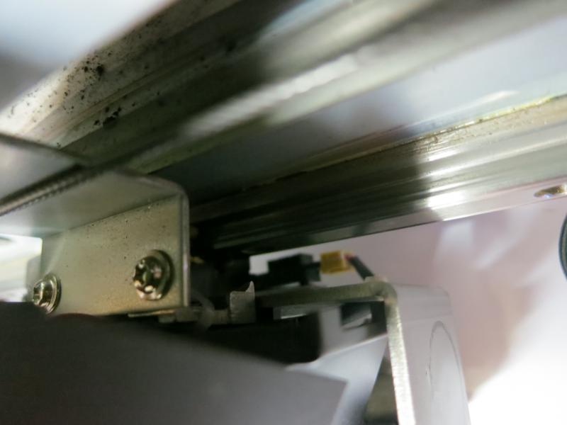

after getting a mirror I found out where it goes!
thanks for everyone's help!!

This piece should have a hole for a screw, might have been broken.
I have the part in stock if you need a new one... Give me a call or PM
