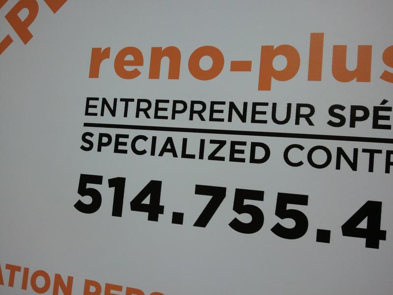

I have problem printing black with my SP540V ... what can cause this (see picture attach) ? There are lines of black going out of the printed text and there's some black ink overspray around some of the letters
I've clean the head, did a powerfull clean and it doesn't help
The only thing that helps a bit is when I choose a beter quality of printing in versaworks.

It's hard to see the problem on the image but if you download it and enlarge the image you will see what I mean aroud the black text
rjssigns
Overspray is usually the result of static. Cyan printing black after sitting for a day or two indicates a bad cap top.

I hang fabric softener sheets across the back of my printer. They need to be almost touching the vinyl. There are more elegant solutions but I'm cheap and they're always in stock. Plus we rarely have static issues. We closely monitor temperature and more importantly humidity.
You never mentioned what the humidity level was in your shop. Anything under 50% your asking for problems.
