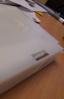

Ken
Pindesign...?
Can you show us a photo of the tab or whatever "popping" out..not sure what you mean..
Thanks..Ken
pindesign
Sure.
First photo shows the faulty black cartridge that we had. Printed dry, tab did not come out.
Second shows a normal empty cartridge.
Sorry about the lack of focus, but you see what I mean.

Ken
Thanks for the photos..I had to have a look at my sp300 carts..same setup.. no problems with that here..so far.
