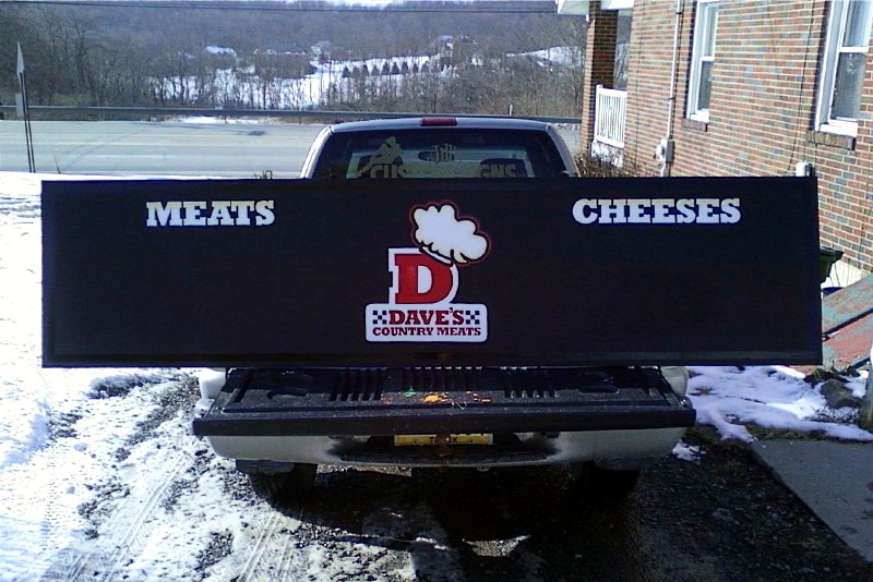

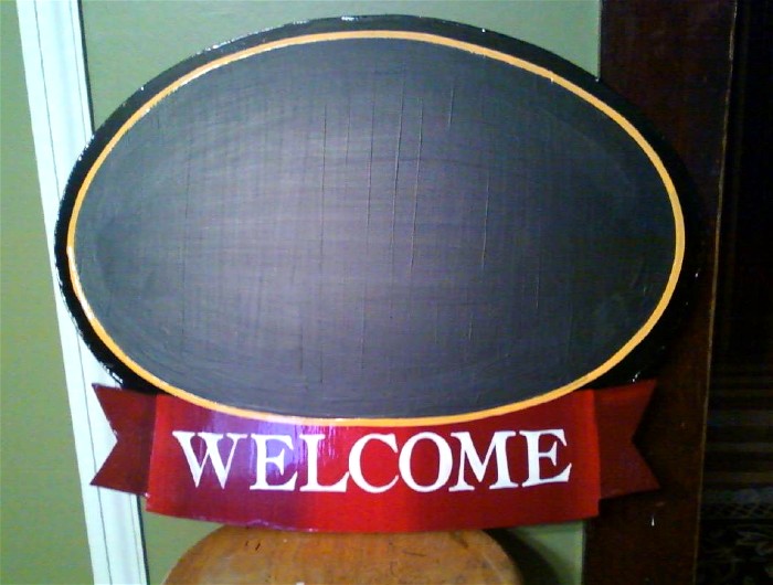

Chalkboard paint is almost flat but not quite, and it kind of has a texture.
I'd hand-letter it, it takes Ronan lettering enamels beautifully.
