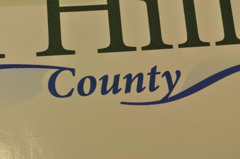

Anyway, I have a Roland Versacamm SP 540i. Lately, the text and graphics look very speckled with white on the colored print.
Cleaned the machine automatically and manually and still the same.
Looks almost spongy when printed. The white speckles are very noticeable.

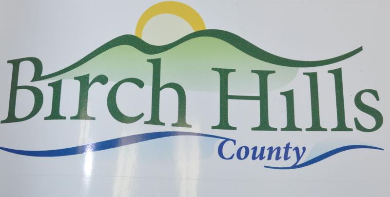

One pic is with a flash and the other no flash so the color disrepcancy but I thinkyou will get my drift with the pics of how griany they are.
