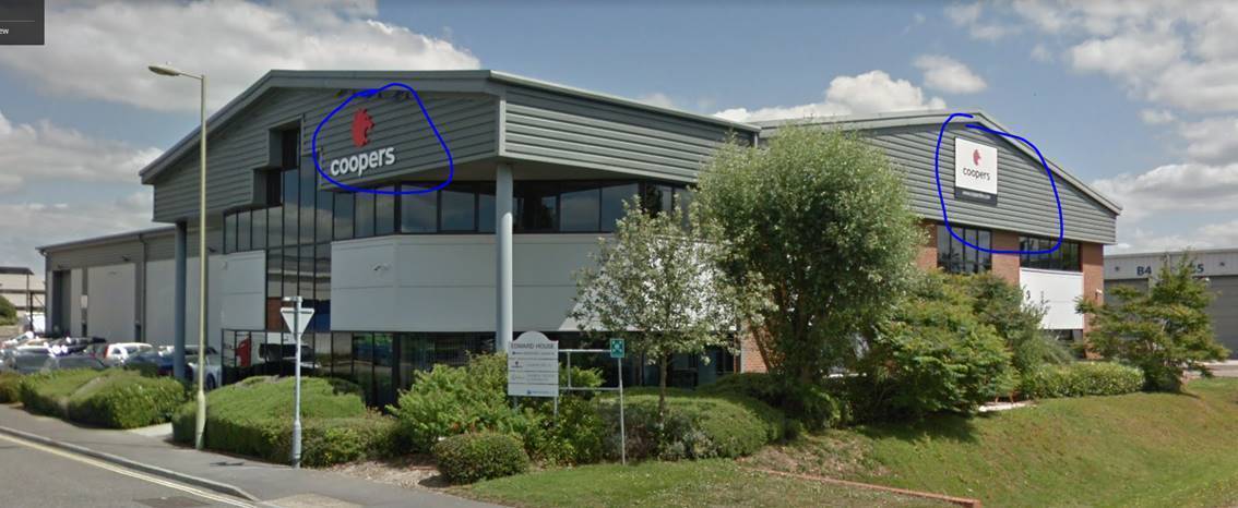

We had to measure up these the other day, can't imagine how it could have been done without. Saves a lot of time for quick quote as well, you don't need two people taking exact measurements for every survey.

Something like that I'd take a straight on photo of the wall and measure one of those window panes and scale it in Flexi. Obviously you have to go back to a computer to do that and I guess that Spike thing you can do right in the field... but I wouldn't be pressured to come up with a quote on site anyway.

How do you measure the siding exactly?
Well you get a ladder go up there and measure 1 strip of siding, how high it is, that way you can "estimate" the size of the signage in comparison to those measurements. Same as measuring windows or doors that are near any signage
Why is old peoples first reaction to deny the advantages of new technology?
Because we are old! I have been brought dimensions from these new fangled cell phone measurement apps and they are wrong BUT it was not on me.
I have a tape measure, well I have several but they do not lie and they are accurate. I wanna get out and climb up as far as I can for a quote I do not want to guess

Why climb anything when you can measure the windows? I guess there must be some hot receptionist that you need to impress by carrying your extension ladder over there...but they are not interested in your old ass.

square-on photo, and a measurement reference, and I'm already more accurate than the +/- 3% phone app. No need to climb ladder in photo above, bricks are ground level and can be used for scale. And then use it to find dimension of the siding, for use to scale the adjacent wall.

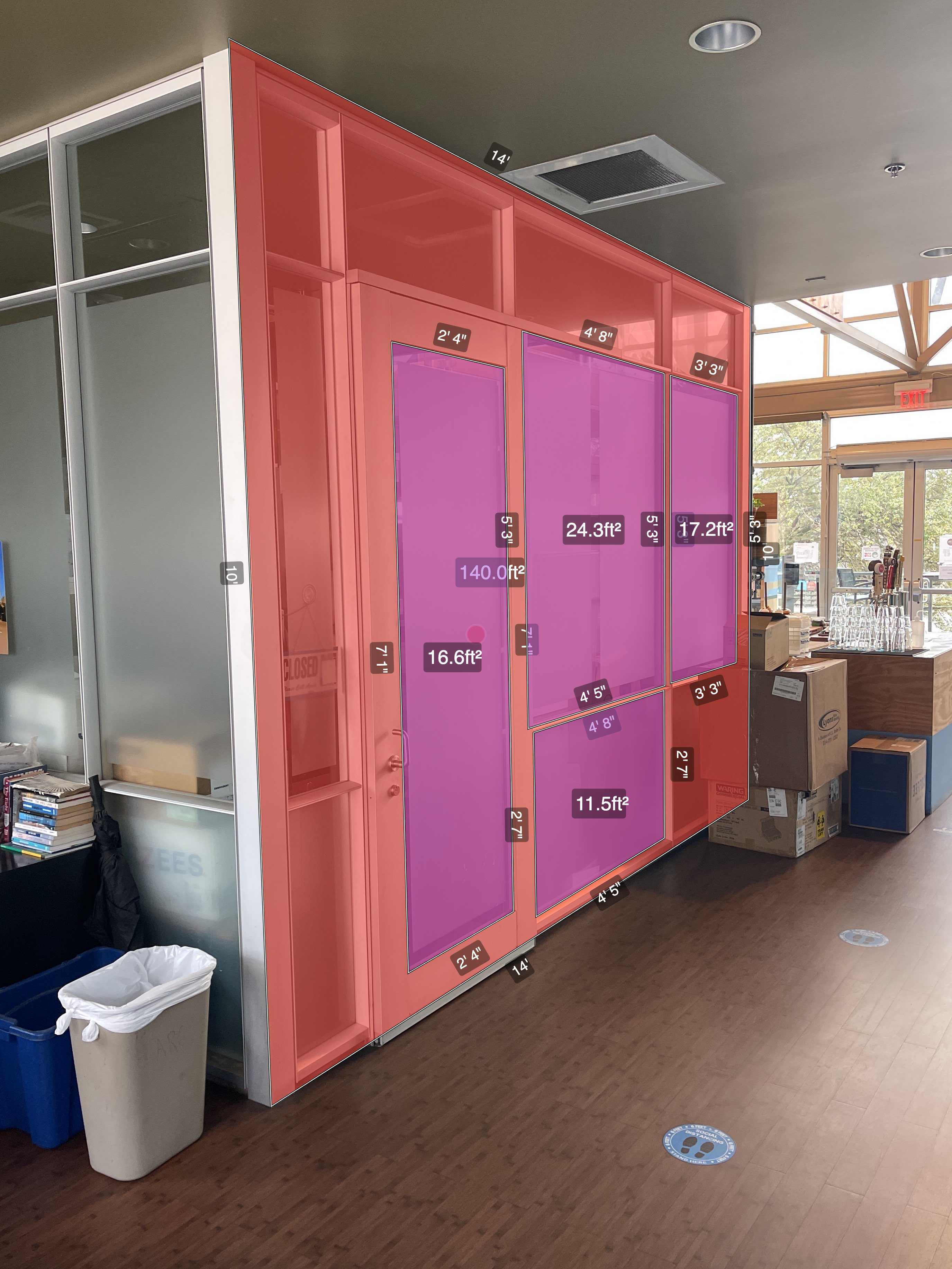

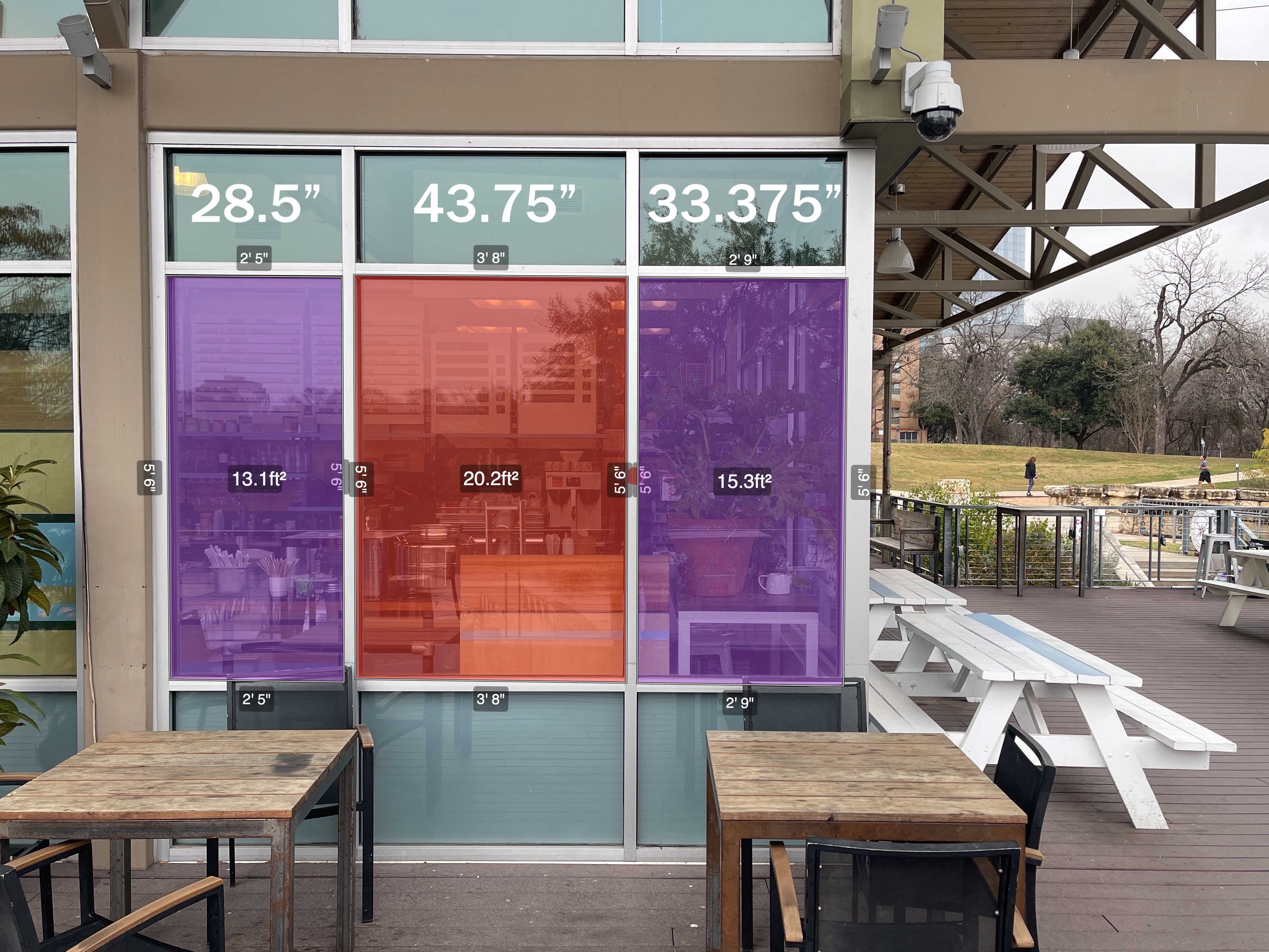

I use it all the time and I have been for years. It rounds off to the nearest inch so when I can, I pull out the tape measure for some fine detailing. For our business: murals, window graphics, event signage, etc, it works great. When I export images, I often add more precise measurements on top when my team needs details. When shooting at glass, I point the laser at a mullion. --
WHAT I NEED, is a process and a price for these sorts of surveys. When someone from out of state is planning an event at a venue and not enough data exists, I need to provide images and measurements but I often uncover something interesting that the clients want me to go back a second time for additional signage opportunities. Sure, I love an upsell but how do I communicate the cost for my time?
PS > I'm about to be 57. Does that make me old? I embraced the hell out of this thing but the younger sales reps haven't.
