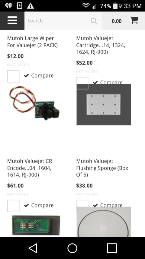

Wouldn't it be the same as the 1604?

I use the 1604 sponge in my 1204. It takes a little work to make it fit. It goes into the flush box just fine when it is new and dry. But, when it gets saturated with ink, it swells up too much for the box and bulges upward. So, after a couple of days, when it starts to swell up, I take it out with a pair of tweezers and cut a little off 2 sides, put it back in and it's good for 6 or 8 months. Signwarehouse sells these (DG-40317) in a 5 pack for $38. You certainly don't have to replace the entire flush box. Search the forum. There is a thread here when a member tells exactly how he makes his own sponges for much, much less.
