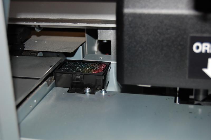

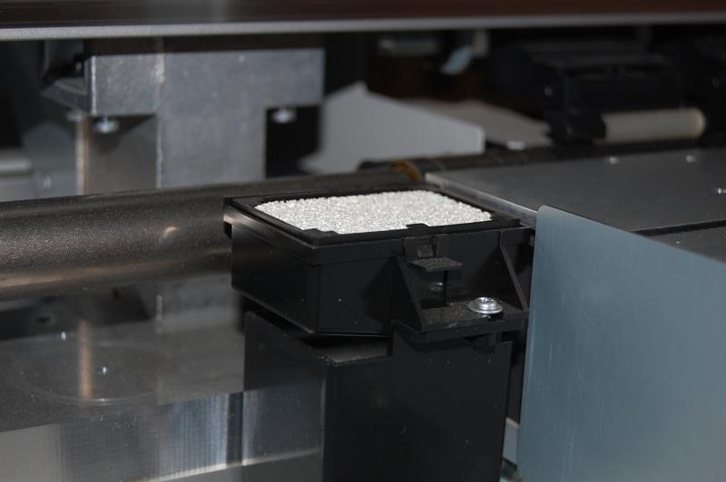

Well I don't know what they are called, but the one on the right side of the printer under the display screen is the one that is saturated. These photos were taken about 4-5 days after both sponges were replaced. I have only run 2 small jobs on this machine since replacement.

I have a 1614 and I rinsed my sponge out and put it back... Next time it will get full I'll replace it. The one on the other side, I thought was a backup so that you could just replace from there, and than order another one so your not stuck without another sponge, LOL

that's normal the one on the left gets the most put onto it.
So it says to replace the sponge after 2 months, but if this is after a week... just seems odd.
The sponge I just replaced was totally black, and for some reason it was out of it's holder and sitting on a piece of metal, oozing everywhere. I just don't want that to happen again.

They start to swell after a couple months... but it is normal for them to be wet and look saturated. That thing just drains directly into the waste tank and it's job is to keep the nozzles wet by squirting ink on every pass.

The upper spittoon pads on the right side of course will get more saturated. The under pad is called the absorber. You can order just the pads by themselves or you can purchase the spittoon pad kit which includes the pad and tray. The tray will get saturated with ink and this will make the tray bow up or downward causing the spitton pad to either touch the head or cause a misting if it sags.
Keep and eye on it and replace as needed.
