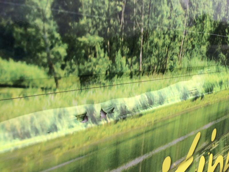

Hi Guys, we're bidding on re-wrapping a Sprinter full body wrap. Customer is unhappy with the previous wrap job because of the vinyl tunneling/unwrapping in the indent areas. I'm attaching a failure picture. My understanding that we should pre-heat the vinyl, minimizing the stretching, and post heat after it settles. Maybe even use 3m primer. Anything else I'm missing? customer wants a written 3 year warranty. Will print / laminate on 3m IJ180-10 cv3 w/8518 lam. Thanks!

regarding the tenting, looks like they spaned and heated instead of laying it into the channel and or didn't properly post heat
