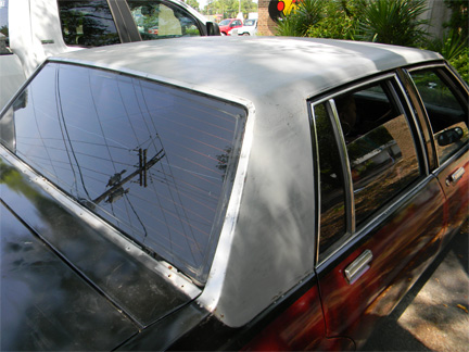

Wondering if any of you could send me the square footage for the top of an '84 Chevy Caprice (image attached). I'm installing a gator-skin seamless pattern. Installation advice welcome as well :)

You might wanna shoot the messenger, but that's your safest and best advice. How many of those are just parked up and down the street ??
Many of those tops were split. Is the one you're doing split or like the picture ??

The chances of someone having a 84 Caprice chilling in their driveway is kind of a shot in the dark, and I'd highly doubt anyone made a template for one of those (not like I trust any of those templates anyways). Just take the time to go measure it like you have to do for any other vehicle?
2B
also you have to inspect the vehicle condition / paint.
judging by the image this is in the middle of or recently repaired/painted. If so make sure the out-gassing has occurred.
if not then then a 30 year old paint job is questionable as it could very easily come off if you try to re-position the vinyl during install.
have to make sure the vinyl is going to stick good
+1 never go off a template beyond getting an idea for quoting
