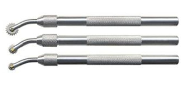

We letter Anhydrous tanks, Propane tanks, Fuel tanks. Painting the logo on is the best method. We have tried vinyl, digital prints, screened decals. Paint seems to last the longest and is the easiest to touch up. So bust out your ponce wheel, maul stick and the brushes, if you even know what a ponce wheel is....
signage
Mosh you talking about these:help
See Mosh we know what you are talking about:omg:

Yeah I know what a POUNCE wheel is, and I'm talking about stainless trailers. Ever try getting paint to stick to that? Don't assume since I don't have a thousand posts that I have no experience. Try 25 years.
