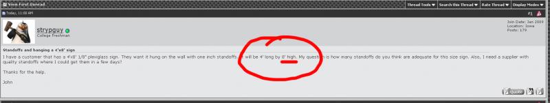

Ok I've been saved. They just want me to letter the sign now. No installation. Not sure what they are doing and I don't want to know. :)
Thanks for the info, I'm sure it will come in handy on another project.
John
CES020
I said one us one losing it, now I'm certain which one of us it was :) That's frightening, as I read that thing about 6 times and never saw it. Maybe the Maker's Mark/blood ratio is still two far up the scale :)

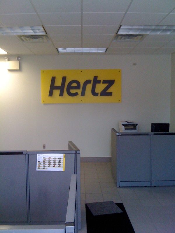

Just did this 3x6' 3/16 plex with 1/2 black letters stood off the yellow panel, Mounted to wall with 6 1" standoffs, I get them from my materials vendor but you can also get them from fairfield displays or outwater plastics. For a 4x8 panel you could get away with 6 safely but I would do 8 standoffs because it would look nicer being a few fqft bigger then the one shown
Offsite pic replaced. Please read our rules and instructions on photo posting.
