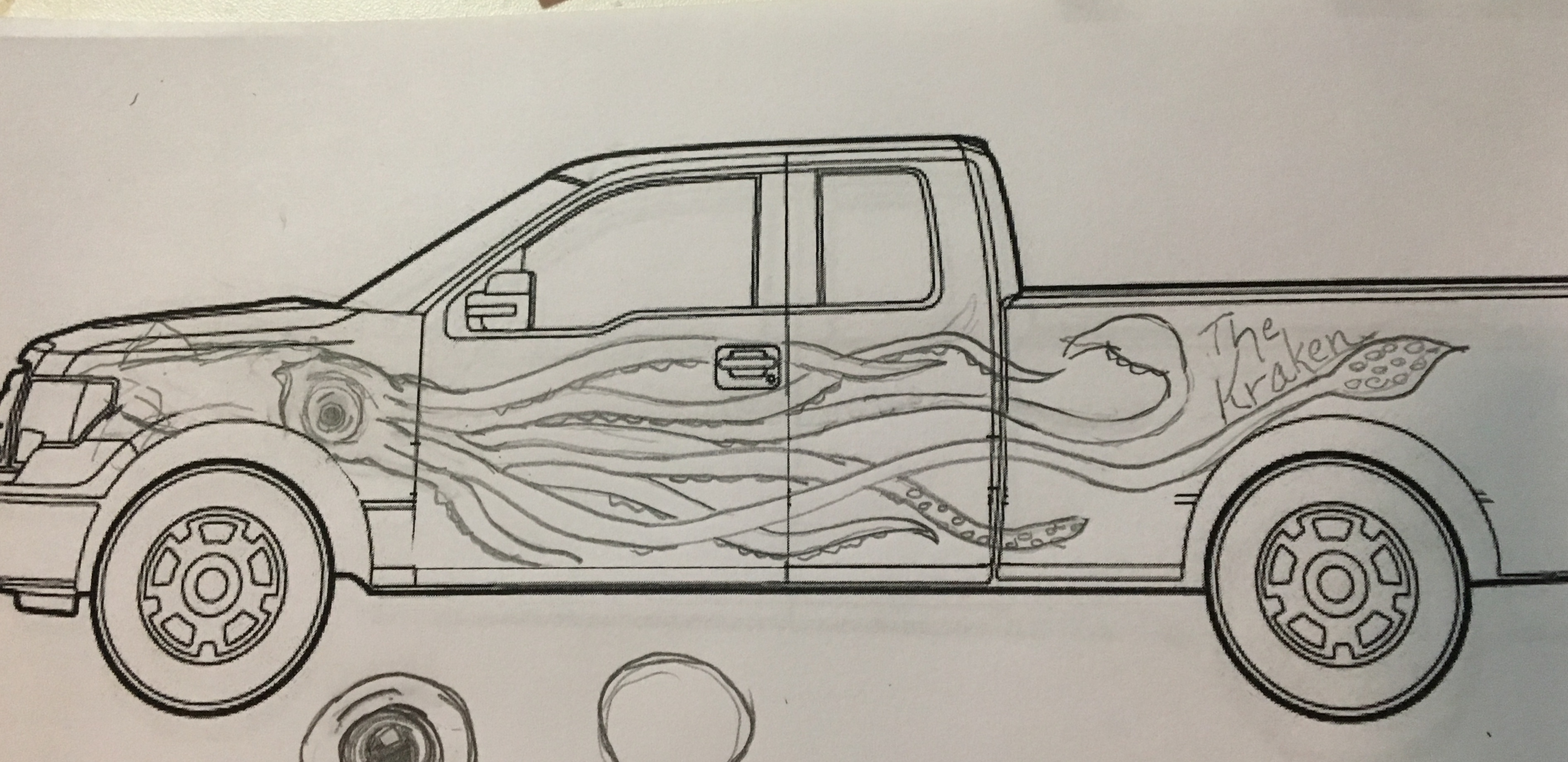

Thanks for the quick responses guys! I’m dismayed to hear your opinion of One Shot. I have never worked with the stuff before. I had originally planned to paint directly on the vehicle. I thought the vinyl was a better option (if possible) because it could be removed if necessary. I wasn’t sure how badly I would have to scruff up the clear coat of the truck. The original idea I had was to put a masking film/tape on the side of the truck, draw the design, then carefully cut it out. This would create a stencil. A rubbing compound would be used on the exposed area, followed by othe appropriate surface prep. Then paint.
Below is the tentative design

thats actually a pretty cool look. and fyi one of my favorite dark rums is called kracken
if you can paint it using a computer program you can make it look like its hand done. i personally would put a water scape behind it and wrap the front fender. driver door window down and the back fender to make it look like a complete piece.
or you could outline it and have it machine cut and applied like a larger decal.
your other option would to be to physically hand paint it on the side of the truck, giving it that good old fashioned 70's van art look.
air brushing it might be a better option. but i guess it depends on how you prefer to paint

I prefer to hand paint... but I have an airbrush...and not afraid to use it. Didn’t want a background... just the squid. Just trying to work out the technical details.
That looks to be more of an airbrushed deal..
Like you said, you'll scare up the clear with 1200 grit sandpaper. Lay down a frisket paper. Draw your designs on that, hand cut it and weed it away step by step as you need the colors. Working back to front, then shoot with a base coat of white and start laying your colors down. Use an airbrush and paint brush and avoid painting vinyl first and then putting it on.
Don't be afraid to do wet on wet. Just let it set up for a bit, then start the next color. Paints bond better wet on wet then wet to dry.
You can use latex paints, but I'm old school and still like the solvent paints.
Good luck.​
