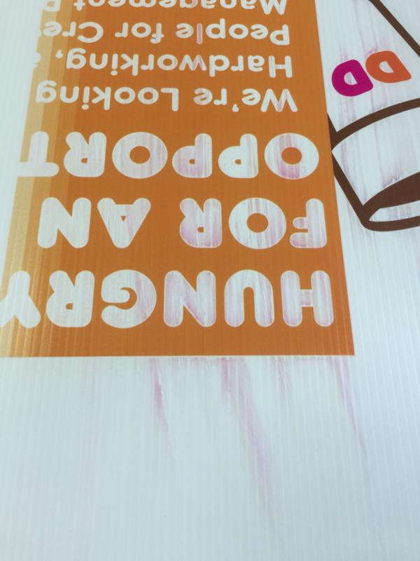

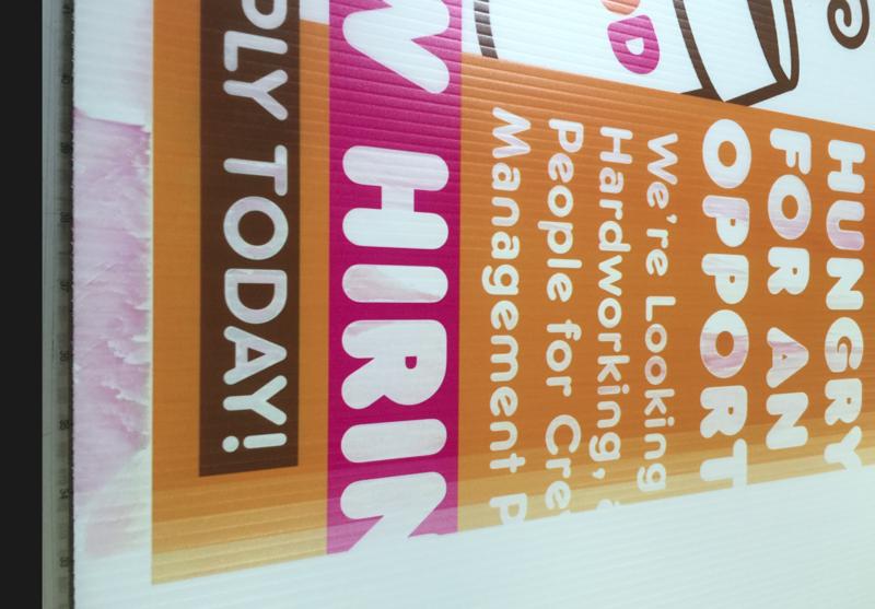

Static issue??? Help!!!! Pics...
DSC
This is the worst i have seen this issue..
OCE 250 GT Flatbed printer
We just printed a sheet before this and it was fine..
This was wiped with ISA prior to being printed..
Seriously am pulling my hair out with this thing..
Any help is truly appreciated..

I'm not familiar with that printer but does it happen to have an ionizer?
My FB700 does and turning it on saved me a few times from these.

To start with, get a humidifier for the shop.
Next, get some of those blue paper shop towels and/or a big chamois. After you're done wiping with your ISA, lightly go over the panel with a barely damp towel or the chamois. At the far end of the panel from your gantry or printhead, place the damp towel or chamois. It will act like a static magnet and draw any residual charge into it and away from your panel. I've also heard of folks putting some dryer sheets on the edge of the panel or lightly brushing them over the surface just before printing.

It does not.. I literally just got off the phone and ordered an anti static kit..
We need that anyway, regardless if that is the issue..
Thanks!

Not to come off like one of the ol' crustys, but "back in the day" when we used to reverse paint plex and lexan faces with Lacryl for illuminated signs and actually hand letter on Styrene, those materials would be so full of static that it would suck the paint out of your brush and turn it into an airbrush like the effect you had in your photo. Your spray gun would act like it had after burners on it.
The damp chamois trick has been used for decades and decades. I'm sure there are all sorts of anti-static devices and products we could be using. We do use Swiffer dusters on our material before we wipe with our ISA to pick up the particulate so we're not grinding it into the surface with our wipe towels.

Great Insight!! Thank you!!
I am going to go ahead do all three.
Install a humidifier
Install an anti static kit
And wipe with fragrance free wipes and put a damp chamois on the corner..
Thanks to all !!

Use an airgun with ionized air, available in the web, and blow over the media.
Use a grounding strap from Aluminium overlay to defined potential.
Use a grounded brush with carbon fibres to eliminate surface static.

WE ordered that kit and have had NO issues..
It is the only thing we have used and so far it is great ..
