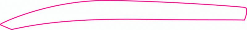

I've read all the posts here on boat wraps. I too am wondering about the curve above the rub rail though. I was hoping some one would post a jpeg of the print they did. That would be huge in terms of seeing what my final layout might look like. My first wrap and its a boat. I got advil if you need it. This picture is my attempt to visualize how to print this. On youtube I've seen them print large and trim. But Im clueless still.

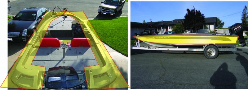

This is what i posted in the other thread linked above.
This....
to this....
to this....
I'm no boat expert, seeing as that was my first and only.
A lot of people hate boat wraps but this was my favorite install so far.
The wrap just fell into place after designing off the template. I think the people who really hate them are trying to lay a rectangular print, and thats just asking for headaches, especially if anything crucial has to line up on the bow.
Funny thing is, i just got off the phone with the owner of this boat. Said its holding up perfect after 1 year, which is great. I was worried since the boat can run up to 80mph. Make sure you seal the edges!

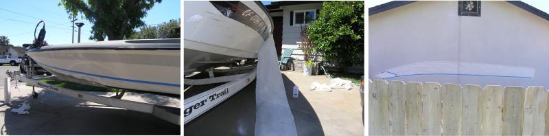

ok here it is step by step. So far I put paper tape on. outlined it with grease pencil and blue painters tape. peeled it and added baby powder to it to keep it from sticking to itself. flattened it on the wall and shot a picture. One step at a time. I'm still scratching my head when I think about doing the gunwales. I hope parkedcar reads this so he could elaborate on his method.
