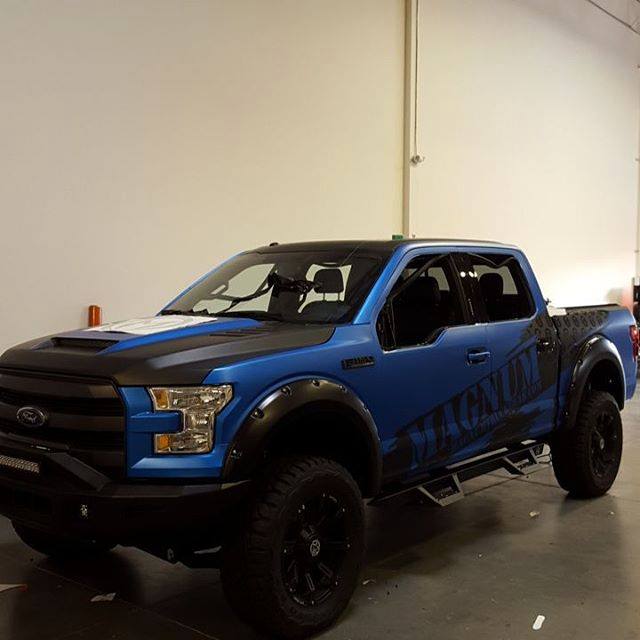

We do 3M matte black with gloss black overlays all the time for a Spot UV looking effect on wraps.
Here is an image of a truck we did last year you can kind of see it on the black splash
