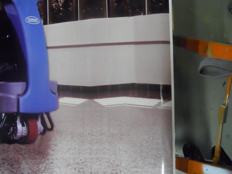

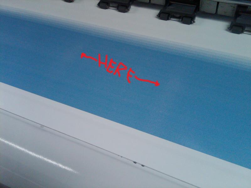

Unfortunately, I have a time sensitive job that OF COURSE has a light cyan background. I've attached photos, any suggestions would be helpful.

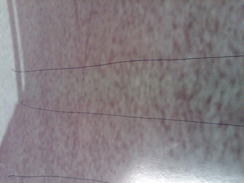

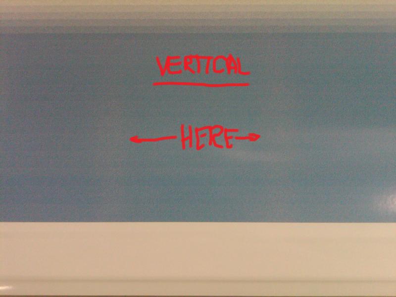

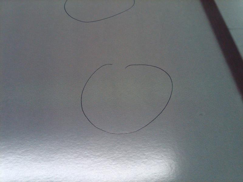

I know what you're saying about the pinch rollers, but it's not that. It's not inline with the actual rollers it's in between or in the gaps. I tried to take a few more pictures, but it's really hard to capture with the lighting and coating on the material.
It's not completely missing, the color is just off enough to be noticeable vertical bands running through the print.
Also, the material isn't tunneling but that was one of my first thoughts, it does look like that is the issue that's occurring.
