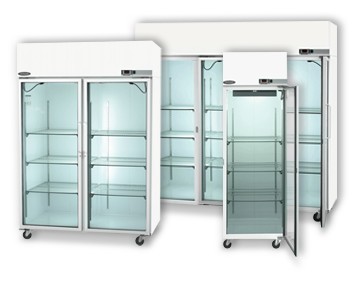

Use a glass front refrigerator unit like the image. Restaurants going out of business usually have them cheap.
If you need to store more build an insulated box with an AC attached.
