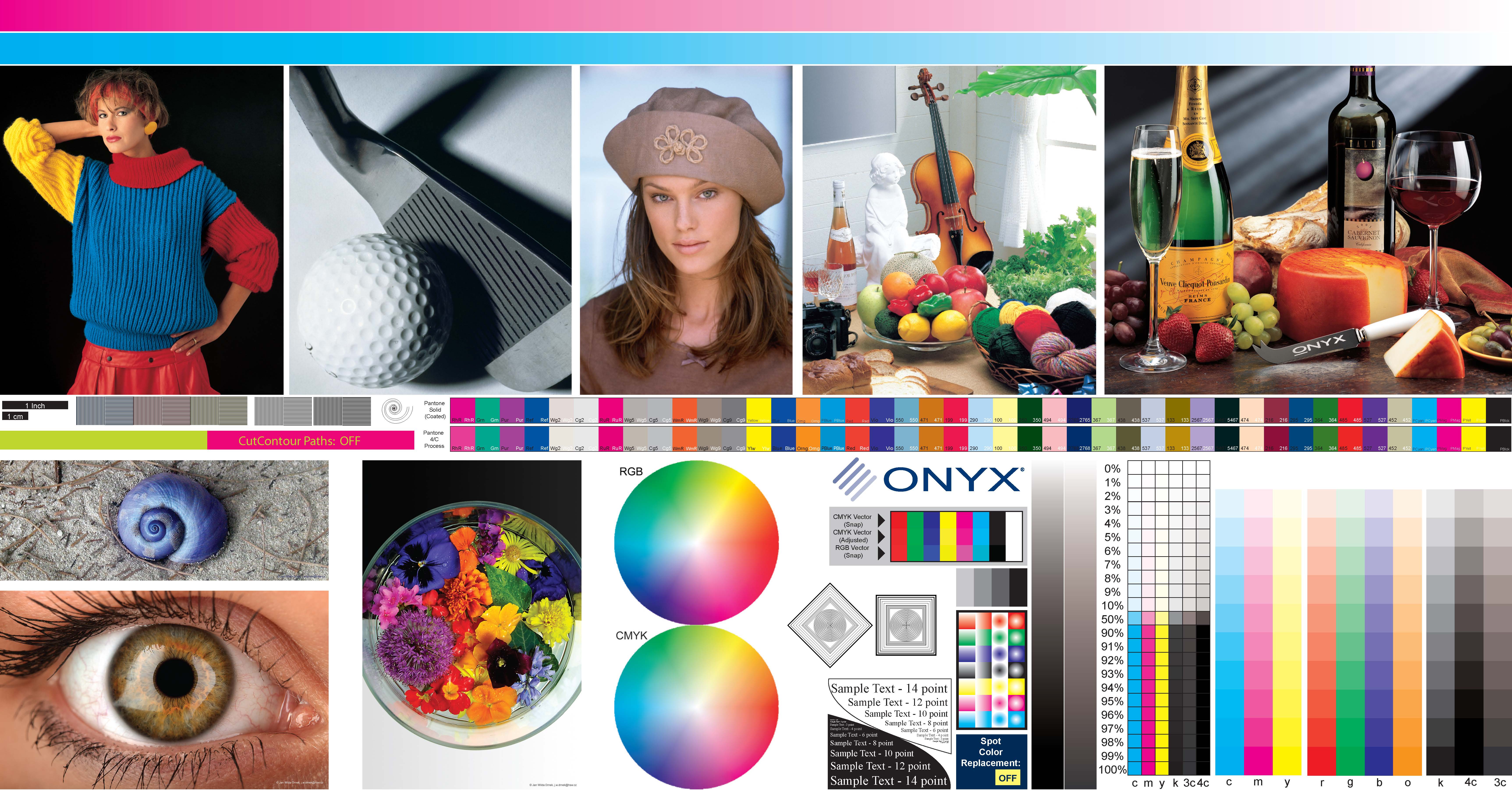

depending on when you are planning on using it i would keep it plugged in till you move it and then plug it in once you get where you're going. also run test prints and perhaps run the attached file once in a while to keep the ink flowing.
if you won't be using it for a long period of time i would use the procedure recommended by zoogee

Thanks! Yes, I think I'll just keep it plugged in next to the new printer at first. Then once we figure out what's going on I'll do the flush, lock and transport
And thanks for the test file!

I would agree with all the above advice, but also if you aren't going to be using it much at home, make up a file with some 2 inch squares of cyan, magenta, yellow and black - enough to fill the width of the vinyl - and print this out every few days. It won't use much ink and will keep the ink flowing through the system and heads, and also the carriages moving, cap top station working etc.... Rolands don't like to be left standing not working, so this just keeps everything moving
