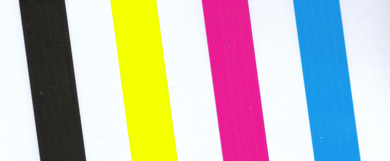

We was off from christmas until january 5th, since I came back, I have had a strange banding issues. My printer is set to wave and super fine, however I am getting strait line banding in my prints on all colors. I setup 4 boxes with cmyk for each box and all 4 colors are doing it. I have tried cleaned the head with a lint free towel, as well as tried removing the head from the carriage to give the head and carriage a good cleaning and make sure nothing was dragging accross the print. The PF Adjustment doesnt seem to effect it at all, neither does the head rank. Anyone have any other ideas what could cause this?

Can I see a sample?

I will post up a sample a little latter of just cyan, I am in the middle of a big job and cant stop right now. :/

The nozzle check does work fine, however there is a line missing from all colors in different areas and magenta has two if I remember right.
I am still printing on this same job and will be tomorrow as well. Hopefully I can get a print that I can scan then or Monday. Also right now I am printing in quality 2, the banding isnt as bad, but its just so slow. Using the same graphics 2 profile I used before Christmas break it is very dull and the banding is very noticeable. It has firmware 1.18, I havn't looked recently to see if a new one has been released, but dont think that is the issue anyway. I have tried unclogging the head with the rag method many times earlier this week and also did a head flush on Monday, and also have used the syringe of course.

Here is a cmyk print, the lines dont seem to show up great, but you can somewhat see them here.
