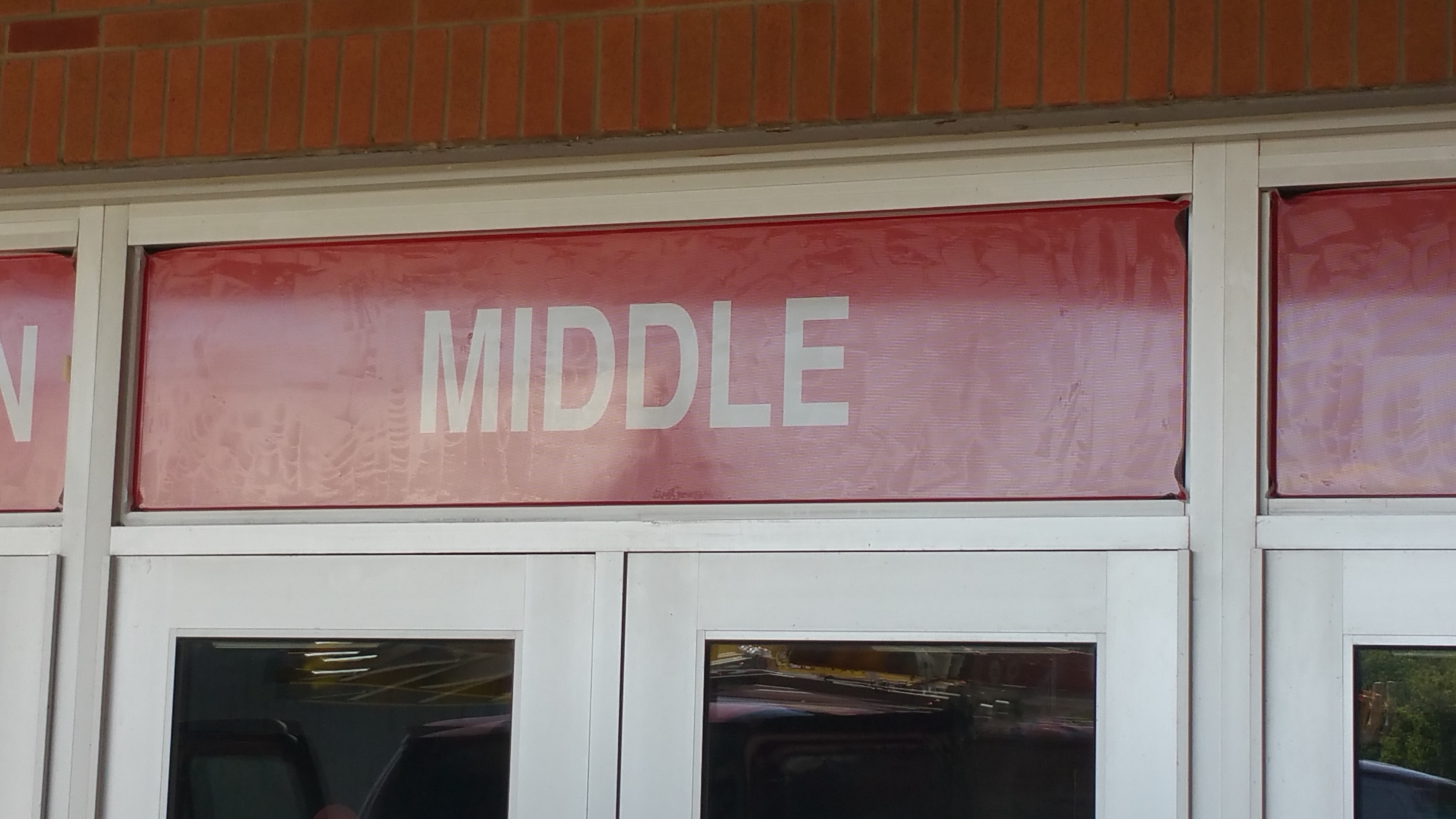

Manuel Upton
Is this what your job looks like? Sounds like the same issue I'm having. I used a 3M gold squeegee with a "Banana Buffer" from fellers on it.

AKwrapguy
What's the deal with the strange marks in laminated window perf film? It's like you can see every squeegee stroke, tell me these come out eventually.
Depending on what materials you using they should come out after a few warm days. The adhesive will flow and even out. You can assist this with a heat gun and post heat when you done. We've done building that looked kinda looked like what you have and after a few days you can't even tell.
