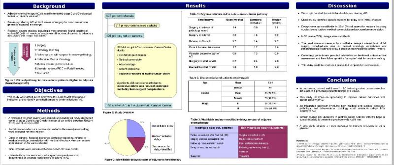

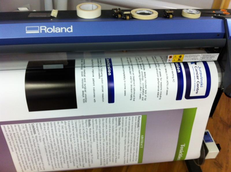

I've had a strange issue on a job that I print once a year. The local university oncology dept. has a research day where we print student's presentation posters. these are created in powerpoint by the students and saved as either a pdf or a tiff and sent to me.
every year we seem to have 1-2 posters that print with a large black rectangle where there should be text, the preview in versaworks looks fine. I have to end up importing the file into CorelDraw and saving as a different file type.
Does anyone know why it's doing this? it's annyoing that it's so completly random. I've attached photos of the screenshot of what it should look like, and a photo of how it's printing.

maybe some sort of clipping mask? i'm really starting to dislike versaworks as a RIP. It's changed fonts on me so many times, and will tell me some files are corrupt when all i do is restart VW and they work.

I guess it shows perfect on your screen. I only see black boxes after I unmask objects, but it is clearly visible on the screen, then I delete the black box and the copy is visible. Mind you I run Flexi and that's a whole issue into itself.

Do the Tiffs ever have black boxes as well? or just the PDFs? If the TIFFS do..that's VERY odd.
I try to convert PDF to TIFF whenever possible (rips faster) and I never have problems, but sometimes PDF's do strange things like your example shows.

PDF sometimes have hidden layers that PITA when printing starts

the picture i posted was of a tiff, i had to convert it to pdf to get it to print properly :frustrated::frustrated:

TIFs can do that if they have been saved with ZIP compression sometimes, or if the checkbox for Save Transparency is left on, IIRC.
+2 we have had this happen also and since you are just taking the customer's artwork and printing it you don't even notice. i usually take the art they send and save it as a jpg so they can approve it to make sure nothing defaulted or dropped out and then when it gets in versa works...BANG big white or black box around some text

PDF issue
Hello,
I checked with some of our Tech Support experts, and they suggested that Tiff (raster data) would not typically present this problem. On PDF, however, if there is special ‘effect’, different layers used on the powerpoint, etc., then it can create issue.

Save the tiff without transparency and that should go away... we occasionally have that issue with Tiffs created in CS6+ Photoshop RIPping in ONYX 10.2.5
