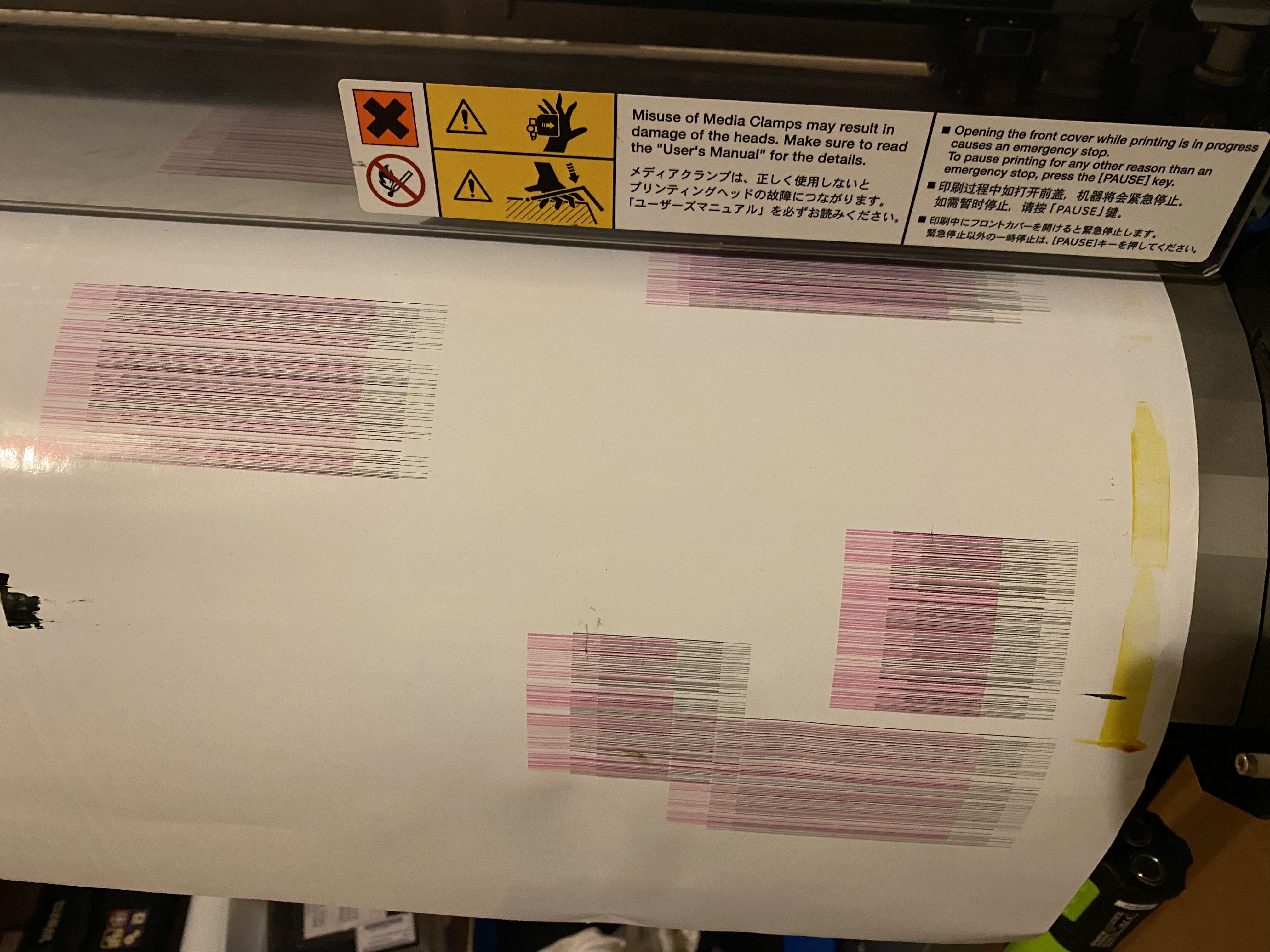

Hello,
I have had weeks of trying to solve this strange Test Print, always hoping it wasn’t the Head. I am getting a test Head in the next few days to confirm it is the head as everything else has been looked at….more than once.
I just want to know if anyone else has had a Test Print like this?
Roland VS640.
Thank you.

Unplug the machine before you mess with those cables, especially on a Roland. They're notorious for blowing head fuses if you look at the cables wrong, and just turning off the power switch still leaves current going to things.
Solventinkjet
DIY Printer Fixing Guide
And if you want to do it 100% right, wait 15 minutes after unplugging it. If you test the power output after it's unplugged it's still outputting close to 100% of the power and it takes about 15 minutes to fully discharge.
Michael Snook
Well, I have replaced the cables and got exactly the same print, so I’m pretty sure it’s not the cables.
Another printhead will help eliminate something!!?? I’m just waiting for it.
