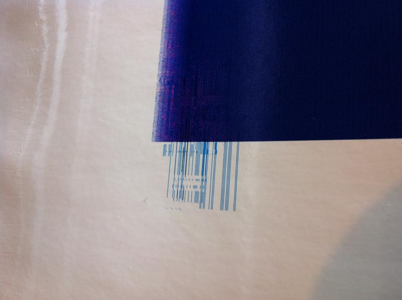

Take a peak at the picture. This happens often that my printer does this, and it's always at the left end of the printer. I almost always use 30" media.
Any recommendations? Should I raise the head when I'm printing on the 3mil calendered?

That looks more like dirty encoder strip or bad data cables. I don't know anything about the machine you're using though.
sfr table hockey
In the photo it seemed ok till that point. Once it starts to do it does it continue or is it off and on?
If you print the file at half size, keeping it starting the print on the farthest right you can, does it do it?
If it only does that on the prints that reach that left side of the printer then it may be a cable issue that is cracking and that's where it bends.
It does look like what some of the other bad data cable issues look like. They tend to be a printed mark and not a blob of ink or a smear.

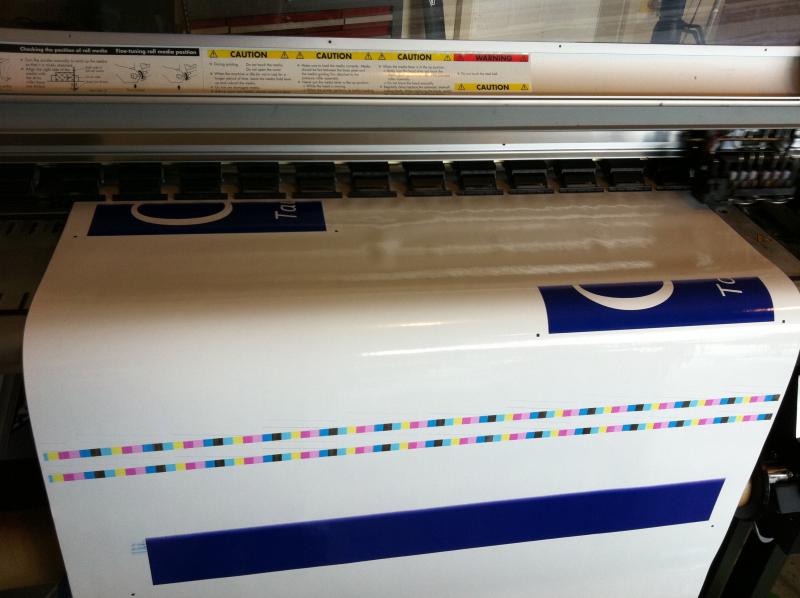

Ok, I tried printing a smaller version, one on the right, and one on the left. As you can see, it did well with both.
Once it starts, it doesn't usually go away. Seems like I have to mess with it, and maybe clean the heads or something to fix it... but I'm not really even sure that me cleaning does anything to fix it.
