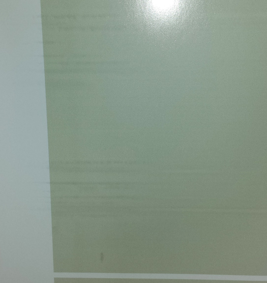

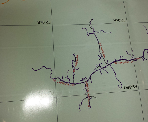

Struggling right now with streaks showing up in the print. (see attached, although I'm not sure how well the photos will show up)
I know that it looks just like contaminants on the media (Orajet 3651) but if I run the very same file at standard speed, they don't show up at all.
I guess it's a profile issue, maybe then.
But I need the speed from my old SP-540V Roland so I run it on high speed. (getting a new VSi soon)
But if the media profile is wrong why would the streaks appear haphazardly, randomly, not a repeated pattern?
Any help appreciated. Would anyone care to say which media profile they use for OraJet 3651? (VersaWorks RIP)

How does your test print look?
Have you tried printing blocks of colors and seeing if you get any lines/streaks?
DerbyCitySignGuy
Do the streaks line up with your rollers? It looks like it could be dirt or ink transferring, maybe? Hard to tell exactly what it is from the pictures.
artbot
probably have a head going out. try a rip with variable dot turned off. if the misting goes away this shows that the head has lost its ability to print the super small dots.
