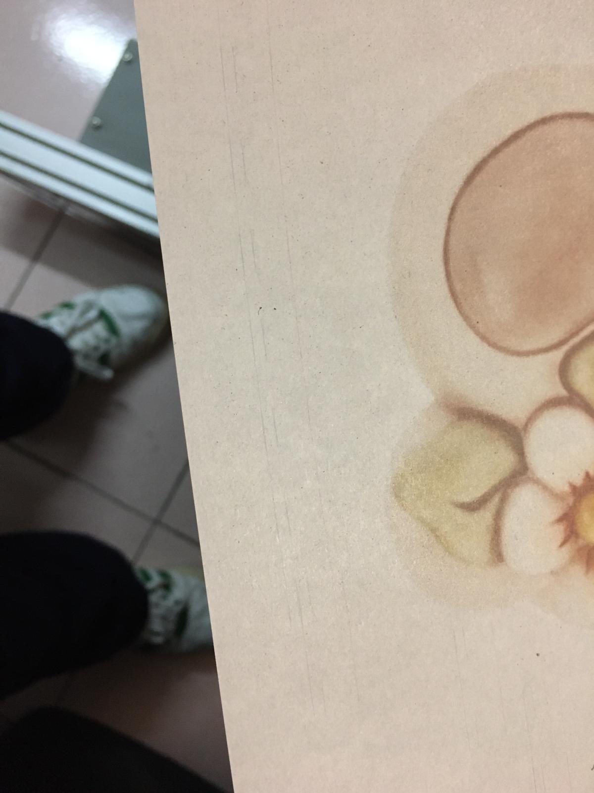

After every sigle print with my mutoh rj900x, i find some stripes, similar to noozle check, as you can see by attached photo.
An other bigger problem: after two/three print the colours are low; i do test print and all 4 colours are bad.
If i do cleaning, all 4 colours are perfect. I think the haedprint is not the problem, i have also changed all 8 dumpers two days ago.
Somebody can help me?
Thanks and sorry for my english.

First thing to do is change dampers and check the maintenance station and capping is functioning correctly.
