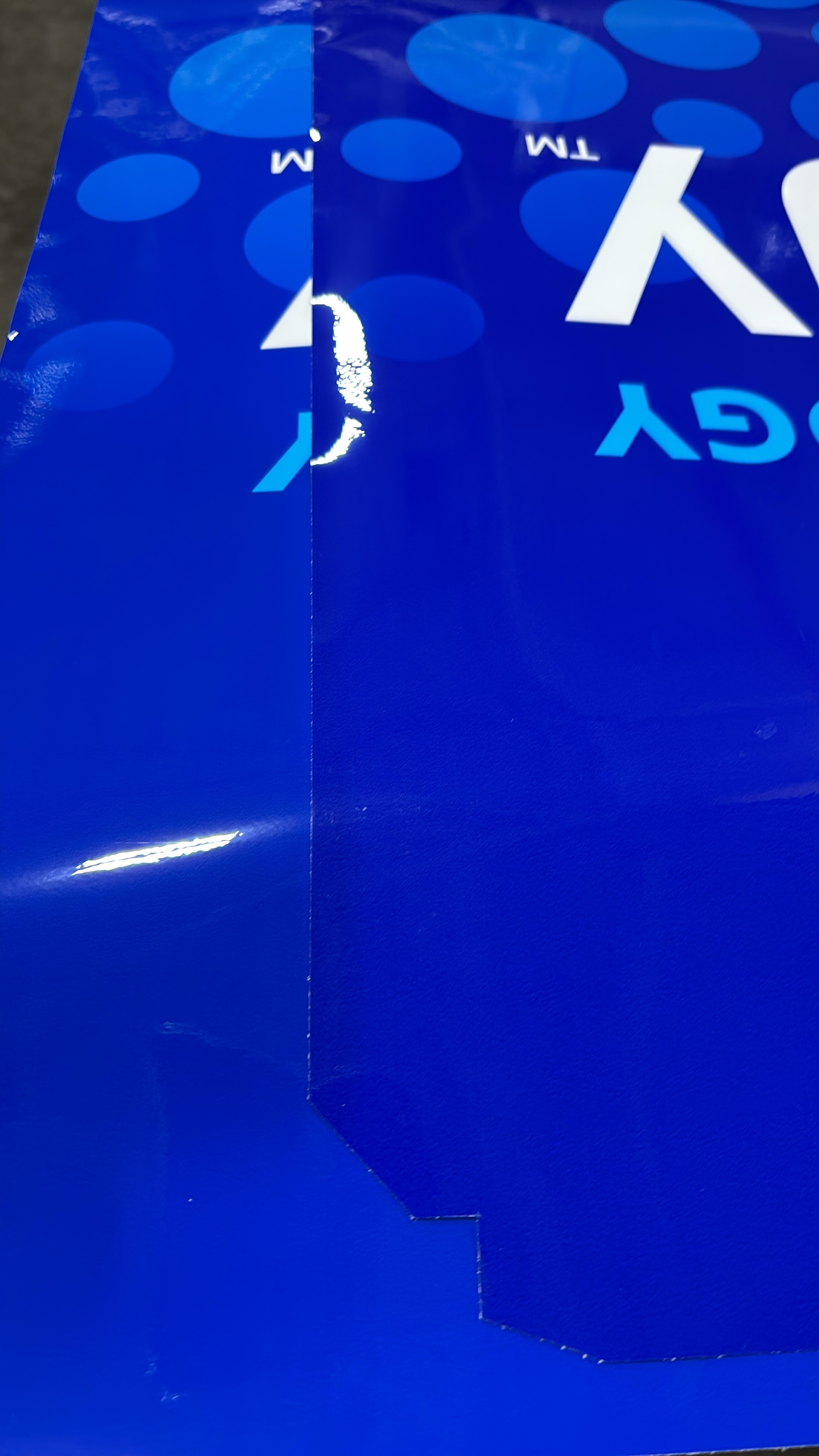

Old thread but here's what happened to our color just be using STS magenta because OKI was out and we had no other option. Same file, and RIP setting. It's garbage.

Color shifting when switching ink vendors is totally a thing, can be a real pain. Though, I've had to do profiling for people when OEMs screw stuff up as well. Different pigment loads, particle sizes and all that fun stuff can make a pretty visible difference. Though, if working in a shop where color needs to be accurate, color profiling with a colorimeter should be a routine operation.
