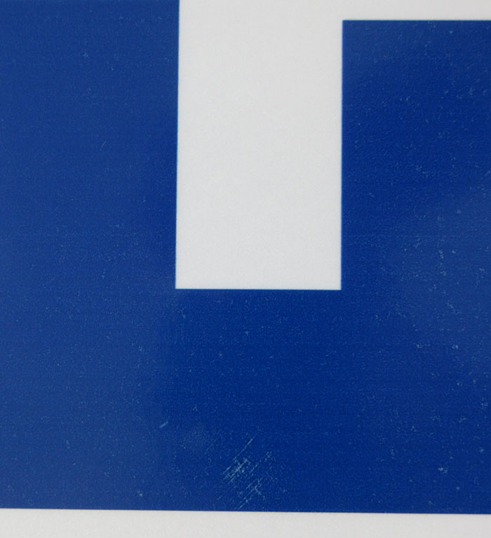

Is anyone out there using the STS inks. I have for about the past 3 months and I have not had any issues until now. I having a problem printing on Oracal 5600 reflective. I have a JV3 160 sp II and I am not having an issues using other materials just the reflective. I have tried several different ICC Profiles, the ink looks as if it is scratched after it is applied. Not a smooth flow. Anyone else with this issue?
thanks

Image worth !!

Yes I am in contact with them now but thought I would cover all areas. I am talking to them at Boca Raton, were I buy the inks. just up the road from us. They are working on it now but have not heard back yet.

Tim, no, the media fresh off roll clean not touched by hands or on floor. I have tried areas on the media up to 8 feet in lenght. The reason I can say that is I printed out the job and then ran across the problem.

OK I just put a scrap piece of 5600 that i had in the drawer and it printed just fine. So I have called my rep at Advantage and I will be talking with oracal to see what's happening. I had a 50 ft rool that was just fine for the first half now it has started this.
Oh well.
thanks for the support guys
