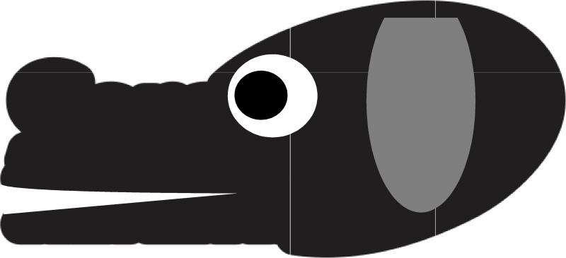

Hey guys, I have a customer who wants a custom routed shaped sign. The sign is a flat panel sign just routed to the shape of their logo. There will be a vinyl digital print applied to this sign.
What substrate and thickness would you recommend? The flat wall is stucco and the sign will be about 8' x whatever is proportionate to the height.
I am not installing this, They have a contractor for this.
:thankyou:
