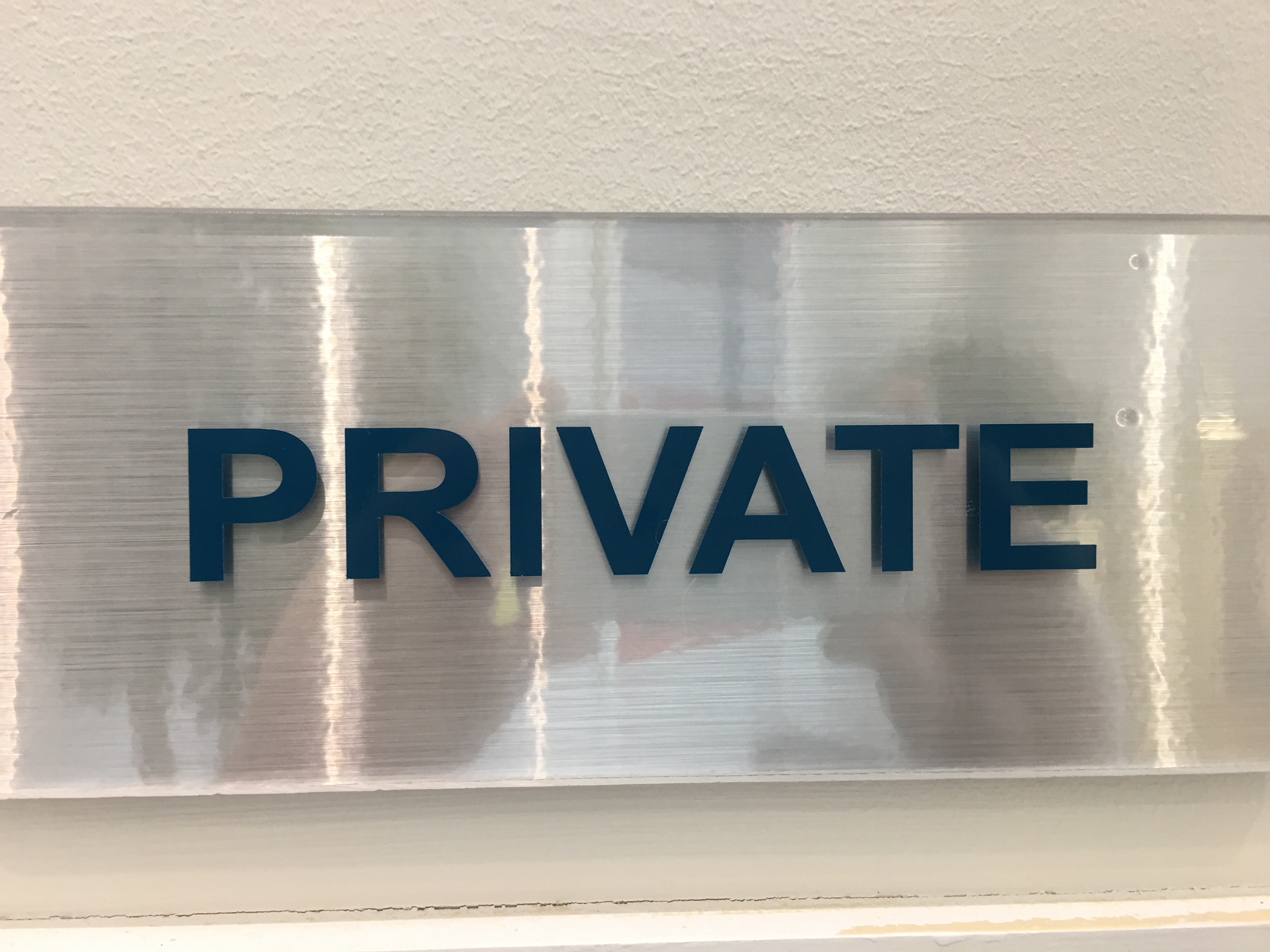

Does anyone know what this material could be? Any help would be great!! Thanks!!

what i am seeing is a brushed aluminum vinyl then something like a clear acrylic and then cut blue letters on top
Billct2
Me too, first surface letters on 1/4" acrylic backed with brushed silver vinyl. They tried for a high end look, but from this photo it just looks cheap
Johnny Best
Yep, like others said, clear acrylic with brushed silver vinyl on the second surface and cut out vinyl (private) on top surface.
