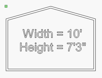

Hey all. A small church in my community has requested a painted wood sign to hang on their building. My 1st thought was MDO plywood. But the size they want is 10 foot wide x 7 foot tall. I've never done anything this big. And I'm concerned about seems/lines showing. Can anyone recommend a substrate to use? I will fabricate a back frame with steel tubing to secure it to the brick wall and brace the substrate from flexing. Any tips or ideas to get me in the right direction would be welcome. Thanks.

His finished size is 7'3", not 5'
i am aware but if a customer comes to me with a larger size like that i will try to talk them in to a size we can do in one piece before i go with the seams but if not then we seam it. i do agree there are better options than wood that will last longer
