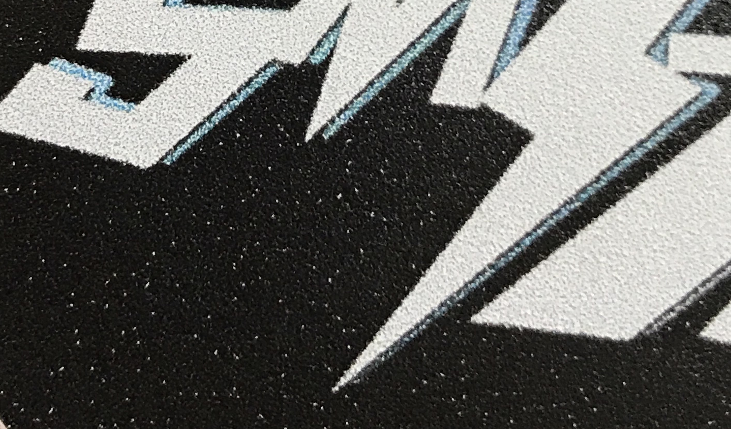

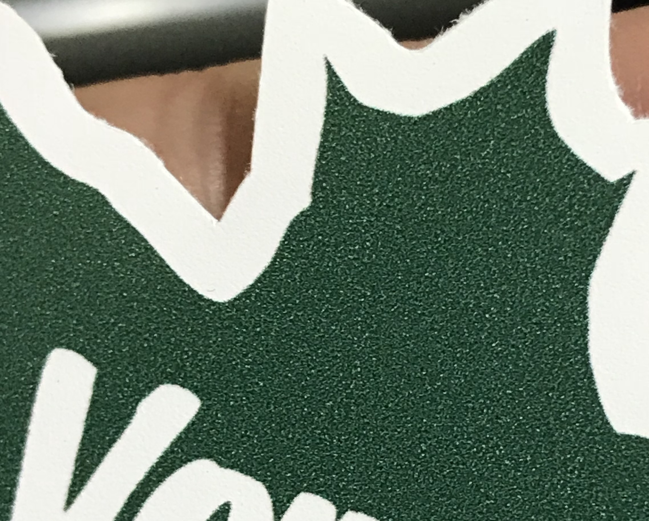

Hey guys,
I've been having this problem lately that's driving me crazy, I run a HP L310 and use italian vinyl (Kemica) which is supposed to be decent, unfortunately I don't have access in my region to a lot of options.

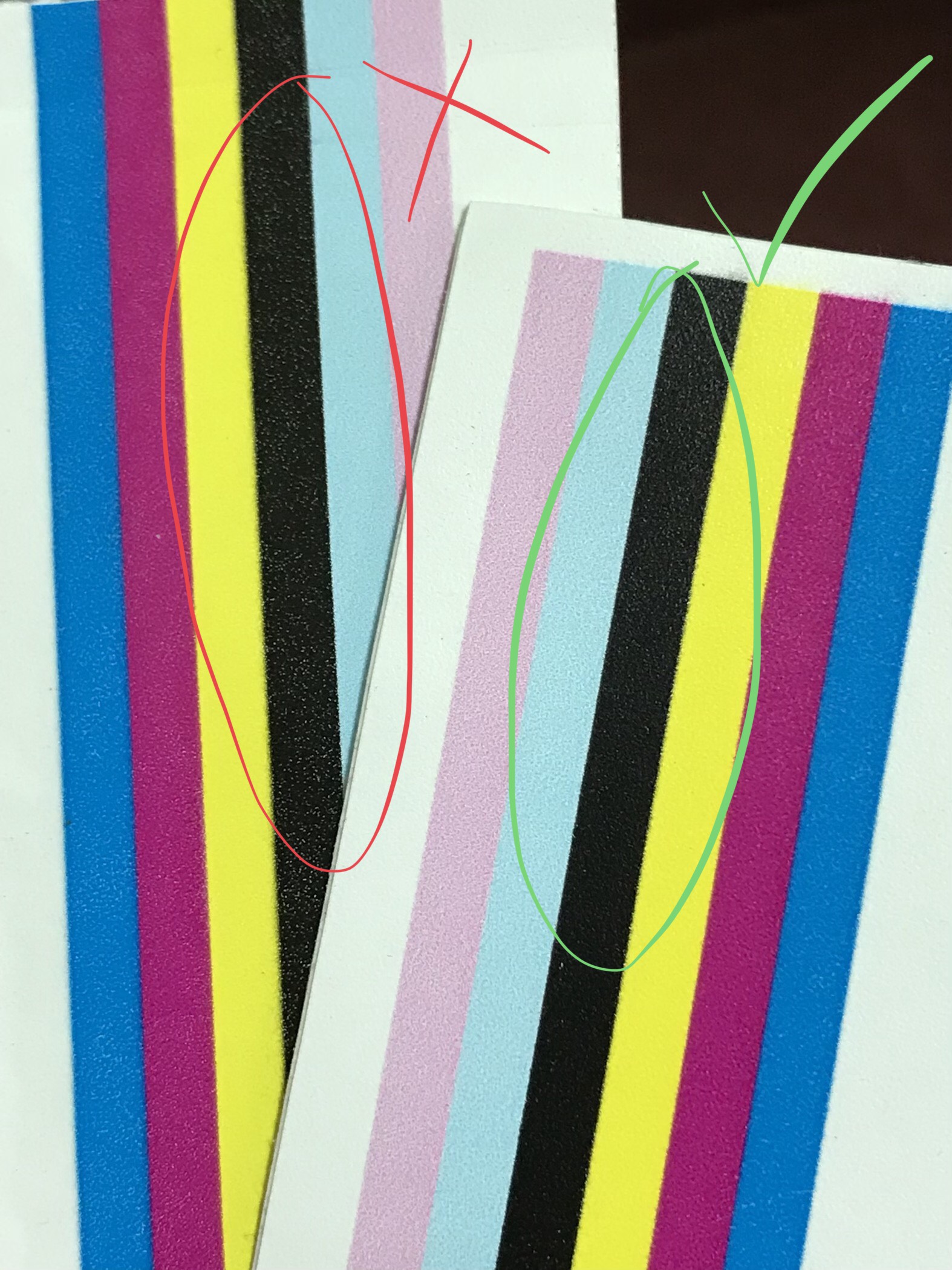

Anyways, the problem: prints are constantly coming out with little white dots, like the printer is not able to print completely on the substrate, I'm attaching photos.
Additional info:
-I've discarded that the vinyl is the problem because I've tried multiple (same brand though, but I doubt all of them are defective)
-It's not the printheads or inks, I describe a way of dealing with the issue (cleaning the substrate with cloth)
-My tech says this is a common problem called "lice" here and that it is due to dust in the room where the printer is.
-The thing is even though I work in a "dusty area" the room is completely closed, windows and doors shut at all times while printing, I try keeping everything as clean as possible since this started happening but the problem persists.
My guess is that the fans on the top of the machine are blowing dust on top of the vinyl right before the machine prints on the substrate.
The only way I've found so far of avoiding the issue is by advancing the substrate a couple of feet and swiping it with a piece of cloth (dry), but obviously this is annoying because I can't run long prints without doing it and I have to do it before each print.
Also if I'm right about the fans on top blowing dust on top of the substrate right before the printing starts it wouldn't be clear to me why "cleaning" the substrate before sending a job solves the issue.
I was wondering if anyone else has experienced this with other substrates and what do you do about it.
All help is very appreciated!
nico

If that's dust, that's an awful lotta dust. What is the media you're printing on ?? I also don't think it would be quite so uniform.
flyplainsdrifta
That looks like it may be more of a profile/ink density issue. Is the material you're using rated for latex use?? And are you using a custom profile or preset one for this substrate?

Im also curious about the material you're using. It looks like it has a rough texture to it?
Wow really sharp eye! I have no idea how you can notice that from the photos but yes you are right, this is the only vinyl I've seen with this type of rough texture to it, I would call it something more like a porous texture (which clients liked and that's why I sticked to it, I'm not yet laminating and focus on small decals, labels and stickers).

I’m wondering with the texture if there isn’t loose particles coming off during the print. Which is why wiping it before hand is helping. What is the ink saturation percentage for the profile you’re using? Maybe try upping it 10 or 20 percent and see if that doesn’t help keep these particles from escaping. Otherwise you might just need to find a better substrate which might be your long term solution anyway.

Just cause the windows and doors are closed while your printing doesn't mean dust isn't the issue. There could be still be dust int he room and the charge from the material going through the machine might attract it to it. If your in a dusty environment you need to keep the windows and doors closed all the time. Also look at getting humidifier
I don't think that the issue is dust though, I also think that it;s the material and the rough texture. Look at increasing your pass count, increase your ink density and play around with the optimizer levels as well. If the material is as rough texture as it looks like what we're seeing is that the ink isn't getting into all the crevasses.

With this amount of "dust" I'd expect there to be a CNC milling within a couple of feet of the printer. I doubt that's the case.
Honestly though I don't think dust is really an issue for this printer. I ran a 360 for almost 3 years in a room with 8 embroidery machines that were constantly running and there was a layer of dust on everything. You could wipe the entire room clean and come in the next day with a new layer of dust. But it never gave us issues with printing.

If it is dust, your machine would have a layer of dust when you open the viewing door... Does it look / feel dusty with no substrate in it?
It does look like not enough ink to me. Some material is like that... Create a new profile/print mode, set it to max. ink and test run something .The colors will probably be way off, ink may not dry if the temp/pass isn't up, bit youd be able to see if the dots stay.
I'd also try making 4 3" x 12" squares, 1 100%C, 1 100%M, etc. Just print a full 100 C,M,Y,K square with no colors mixed, see how the media handles it... And it should rule out a bad head / ink issue by using seperate ones.
I know your media options are limited, but I'd also try to get a roll of a different brand... Even if it's a really crappy one, just for testing.
