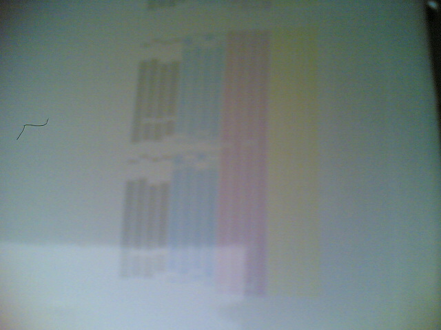

I got some color now but look at this nozzle print. the lines are sharp and nice, but its totaly messed up in the middle as u can see. any idea whats wrong?

Power clean
Hi,
This may be obvious steps, but I just checked out printhead cleaning on Roland DGA's support page. If you have this many jest out, you need to do a Power Clean. Have you given that a try yet?

The [/FONT][/FONT]Powerful Cleaning [FONT=Neutra Display Alt,Neutra Display Alt][FONT=Neutra Display Alt,Neutra Display Alt]should be used when 40% or more of the nozzles are missing, such as the image shown. [/FONT][/FONT]

ozzy666
Look at the head surface,if you see ink drops then take care about cleaning cycle\wiper
If surface is clean then its still clogged:
Put a few drops of cleaning liquid(must be the same formula as ink you are using) into capping station,close the tubing so liquid stays inside and leave it overnight..
