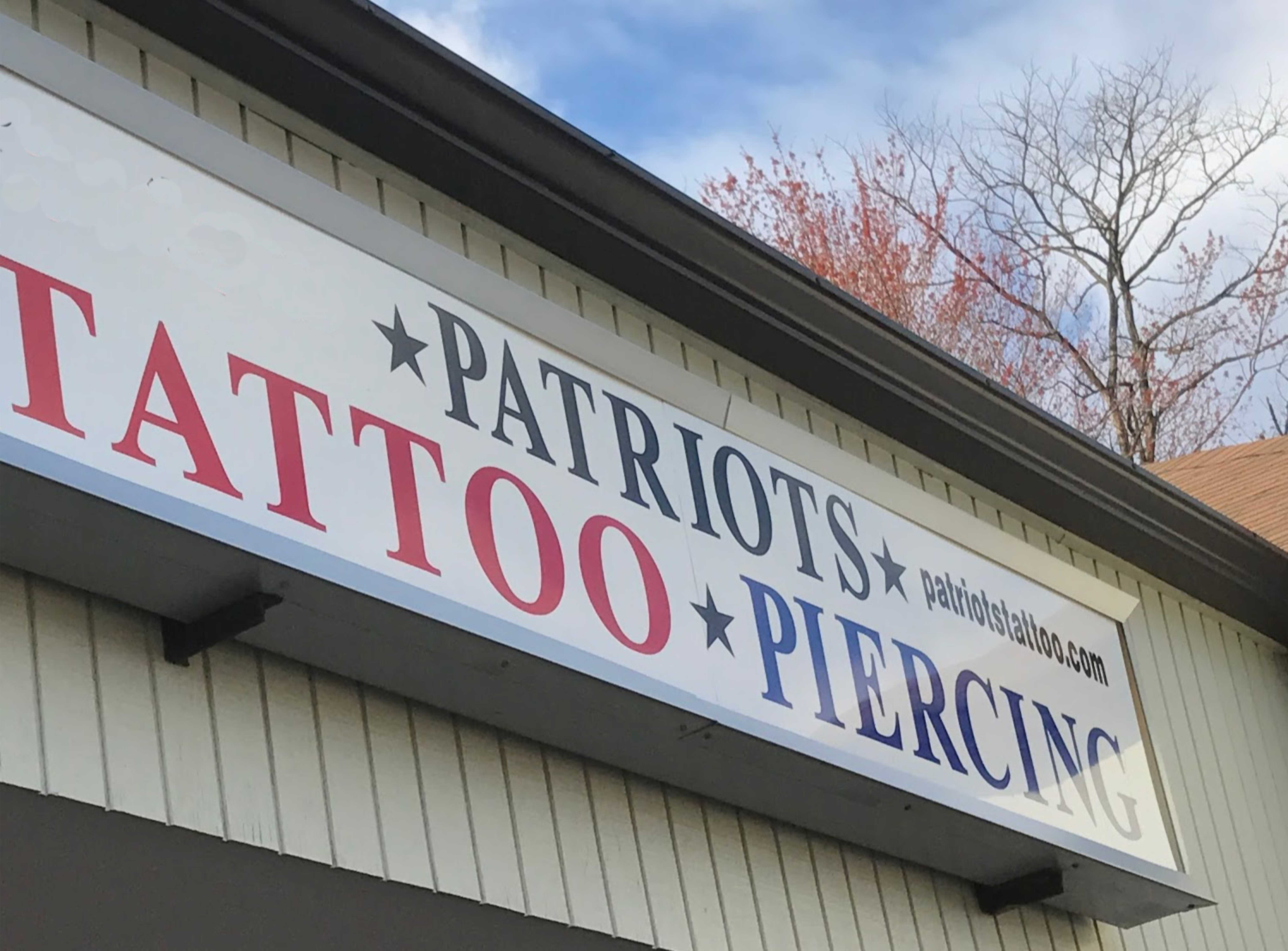

I need some advice on changing out the face of this sign. The size is roughly 2ft x 8ft. I want to go with a full color face instead of individual vinyl lettering. Any suggestions on type of substrate and media to use?

Printed graphics applied to acrylic, 3/16" thick. There are lots of ways to produce. Someone posted a link to 3M's recommended method about a month or two ago- it's a very good guideline.

For the printed graphics, are you referring to something like a backlit film with laminate?
The 3/16" acrylic is what i was thinking of too. Wasn't sure if acrylic or polycarbonate would work better. Thanks.

I'd use a 3mm polycarbonate from grimco and a oracal calandered translucent print media with compatible overlaminate. I'd also look to replace UV tubes and retro fit with LED as they are cooler and brighter. Will also stop the heat vacuum.

For the size, polycarbonate is overkill- in my opinion. If the customer will go for the price, though- why not?

3 mill acrylic (be very careful with this stuff) and digitally printed graphics on clear, if its alot of detail. Use the top end vinyl.
If you were more experience i would try and remove tattoos and just use the panel its on, those letters should come off pretty easy.

Thanks for all the input. I'm a newbie at this type of signage. The acrylic and polycarbonate seem to be about the same in price. I'm hoping I can print the media on my HP Latex and then laminate. Once laminated, I would mounted to acrylic.

upsell them on polycarbonate (lexan/makrolon). 2x8 is small by comparison to where I would say its absolutely necessary to upgrade acrylic to polycarb, but indestructable is always a great quality for sign mfg./warranty.
besides, i bet that face has a lot of wiggle-room inside that cabinet, acrylic still could shatter in a cold-windy winter storm.

The size is fine for acrylic unless you drop it, we print translucent film with HP, 2 layer print - there was a discussion about a few months like someone said earlier. We print white / clear then lam. 1st surface application, or if you want second surface you can print double layer clear and apply white trans vinyl behind.

3/16" Polycarbonate with a Printed/Laminated Translucent vinyl, then you are good to go.
