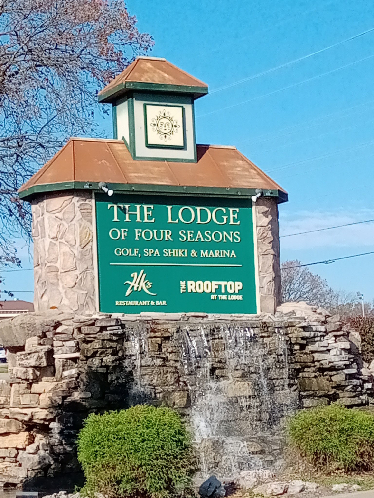

Stucco duct tape. You can get it at a paint store. We used it on our recent Gemini letter job on a stucco wall.
Don't have a picture of the taped up pattern, but it worked perfectly even though it was not only cool but windy. This was the job:
