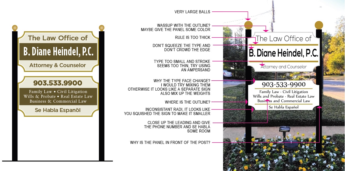

Below is the artwork the customer supplied and then below that is a layout that I drew that I thought made it look better. Any thoughts or suggestions?

What is the reason for 2 separate panels ?? By their measurments, it's basically a 4'×5' sign. So, why not treat it as that size ??
:roflmao: yeah, you're probably right. You can tell the supplied drawing was from another hack shop and that sounds like a trick they'd pull. Then, ya don't hafta buy a new sheet.

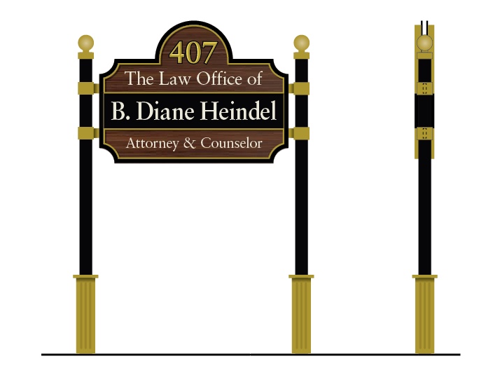

I dont think a sign shop made the first design... at least i hope not. Thank you Rick and Johnny for the ideas.

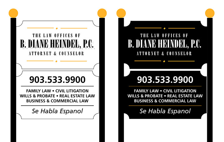

Their current sign has two panels on it now, so I'm guessing they like that. That would be a lot of copy to digest on one panel no? Readability is key here because they are just after a curve on a one-way street up on a hill. Right past the sign is their shared driveway and you have to act quickly if you are looking for them the first time. I passed them because their old sign was not readable and is a royal pain to turn around and try again...whoever designed the streets in that part of town was on acid.
Johnny Best
That is what 85% of sign shops design. Your doing purple double dome if you think otherwise.
Also Rick gave you good points to adhere to.

readability is the key here....LOL
nobody is going to read any of that. people look for names and addresses on signs, the rest is crap...yes, even the phone number is useless.....

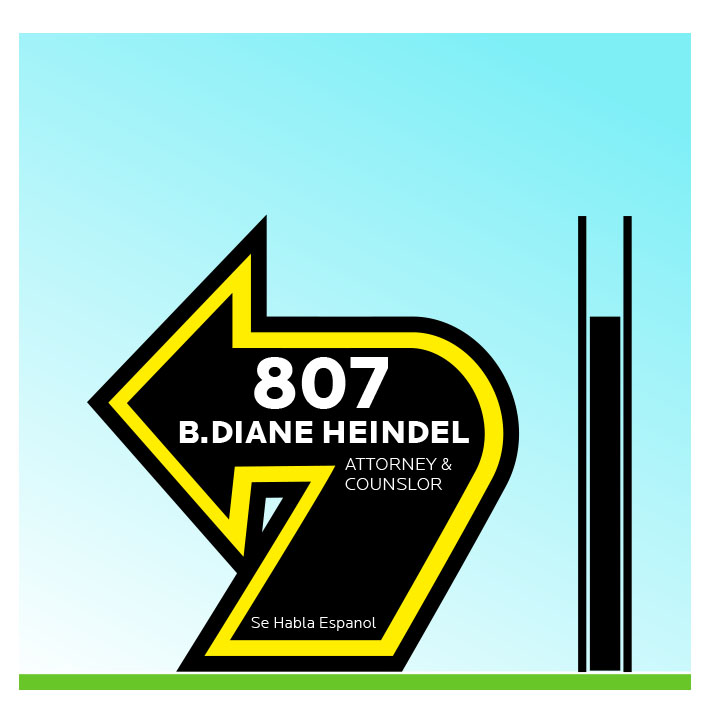

I don't have much other then to say that I don't like the upper and lower signs having the same shape. I feel like the top should have the special shape and the bottom should be more like runners or strips.

missing the obvious point that this used to be a sign for two different places now one knuckle head wants it all for themselves but the sign guy isn't telling him what he needs....
In a trillion years I would never do this. this customer needs to be told that the signs have to be removed and one sign goes back up.
it's not worth the money to make crap.....and breaking up this sign into two signs cuz thats whats there is CRAP
