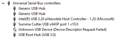

Does the D60 show up in your Device Manager?
Press the the 'WINDOWS' and 'X' KEY together and click 'Device Manager' and look under USB Controllers. (The cutter needs to be turned on)

No it dose not show up, says software is up to date and device is working properly on all usb.

Thanks. I found the cutter. Installed winplot, but having problem getting pattern from corldraw X3 to winplot to cut.
