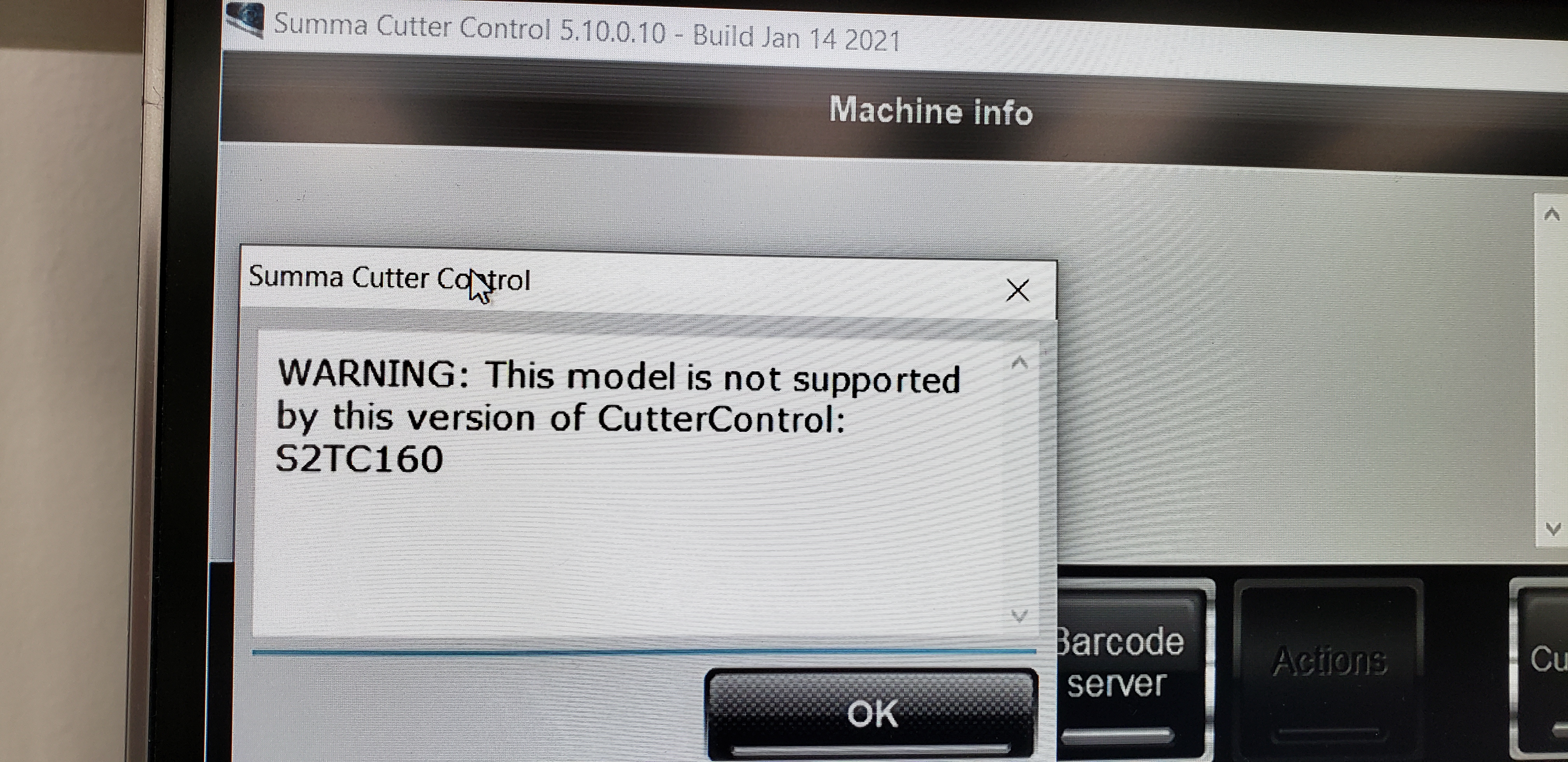

Hey guys, we just recently picked up an S2160T OPOSCAM and we run Flexi 21 Subscription primarily.
If they are both running for a few minutes eventually Cutter Control keeps saying "No Machine Connected" and I have to close Flexi21 Production Manager to get the connection back. Then reopen and send the cut job.
As an aside I also keep getting this on screen error (see pic)
Any ideas?
Thx in advance
-N8

CAM units require USB.....You can ignore the error message it's a false flag.
Try using PM as your barcode server, Cutter Control must be open in the background, verify your camera is getting a picture(Actions/Camera Control) and you should be good to go.

Summa Tech Support just reached out... here's their reply:
"Summa Cutter Control ( SCC ) is reporting that the cutter is not compatible because Flexi is a communication hog.
Once Flexi opens a communication port with the cutter, it never closes it. If you try to operate SCC while Flexi is open, there will be communication issues like this one."
"The workaround is making sure that the "Barcode Server" within SAi Flexi is turned off before using SCC to communicate with cutter.
I'm not sure how to do this, but I know there is a setting within the software.
Or simply close all modules of Flexi, make changes with SCC, then, once you are finished using SCC, run Flexi again."
"I didn't notice, you have a cutter with an OPOS-CAM camera sensor for barcode and registration mark detection. You have to make sure that Summa Cutter Control ( SCC ) establishes communication with cutter and makes the OPOS-CAM module available before ever initializing SAi Flexi.
If communication with the OPOS-CAM module of SCC stops, you have to do as described previously, turn off Flexi Barcode Server or close Flexi completely, re-establish communication with SCC and then execute Flexi."
