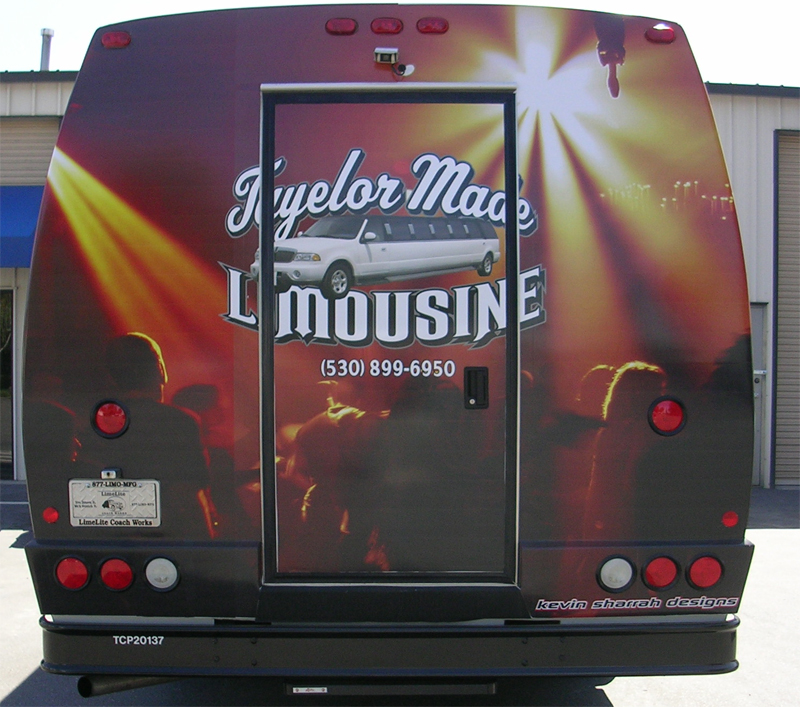

You still want to Lam every thing you do. I operated one in the past. The print scratches really easy, anything will take it right off the material. The print is suuuuuuuuuuuper slow. Sometimes when the ribbon would run out, it would snap the ribbon at the end making you start the print all over, which sucked when we were doing big prints. You definately have to keep it in a climate controlled room. The shift in temperature messed with the print pretty drastically. If you are ever doing panels that you want to butt up side by side, do not count on them matching at all. Anything with a gradient is suuuuuper hard to achieve. So many settings you have to play with to get it right. Here is a pic of one of the last things we did before I left there. You can see the left side pic was printed in the morning when it was cooler, then how faded it got when printing in the afternoon when the temp went up. The shift was between 5-10º. The banding is horrible. Nothing we ever did got it to go away. I hate to be so negative about a machine, but I am so happy I no longer have to work with this thing. Summa tech support was good. We had a few reps fly down and help us with the prints and their response the 2 times they came down was that... the print quality isn't all that good because its meant to print graphics that are going to be seen from a distance, not close up. We also needed a better climate controlled room....which we really couldn't do any better than we had. My boss had another AC unit installed which helped but we saw bad prints still. If you plan on cutting material, be very careful cutting on Summa's material that they sale. The "high performance" vinyl they have, because the backing is plastic it builds up static electricity on the machine causing it to feed weird or sometimes stick, or the plastic being slick the wheels wouldn't grab and we would have messed up cuts as well. Same thing happened on their clear vinyl too.
The one plus to the machine is that you can print the metallic and fluorescent ribbon now.
