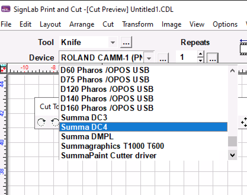

I seem to be able to get to my Summa through Signlab Visual Production Manager, but not Signlab 10.0 print and cut. The only device that shows up on Print and cut is my Roland GS-24. Its been so long since i first tried to set this up that i am sure i am missing something.
Nevermind, i am guessing Visual Production Manager is the printer portion of signlab print and cut, i see when i select print and cut in signlab it sends it to visual production manager. Now i guess i just need to mess with settings and colors and see what ive got. any tips for original set up to make things run smoothly?

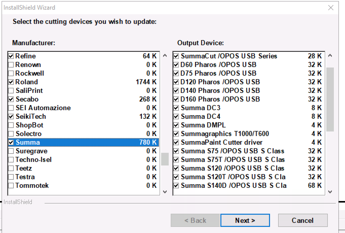

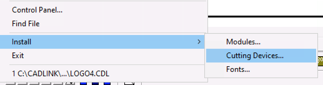

Have you Installed it as Cutting Device?

I was finally able to get my surface and the printer to connect via usb last night. Was able to get it to do a line feed calibration, and then i attempted to print and cut my logo and it print pretty well, needs to make some adjustments as it was pretty pixely, but then when it went to cut, the cuts were off and cut right through the graphic. And of course i am at the end of the roll of vinyl i had on hand. So now i am looking to purchase a roll of print media. Is there a particular vinyl media that works best with these Summa machines? Most of the print vinyl i see at my normal places i shop are all for eco solvent and uv inks not thermal. Any help is greatly appreciated, i need to purchase more vinyl before i can continue dialing in the machine.
